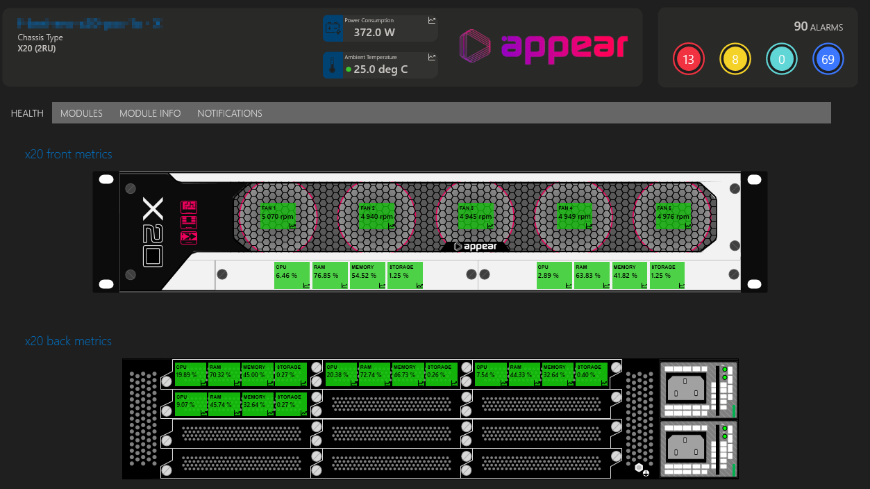

  • Real-time module status: View connected modules with real-time health information, emphasizing key metrics for quick insights and diagnostics.

Visual Overview
By using the integrated Polling Manager Table, you can speed up the the most important polling parameters for your use case.
