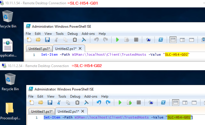

  4. Add all server names to this list. For Failover DMAs, this is simply the other server. Use the following command for this:
    *Set-Item -Path WSMan:\localhost\Client\TrustedHosts -Value "SERVERNAME"
    *For example, for an internal Failover setup, this looks like this:
NOTE: Only do this if there is absolutely no other option, as it may degrade security. See also: https://community.spiceworks.com/topic/2027703-how-to-use-invoke-command-with-remote-local-administrator-account
