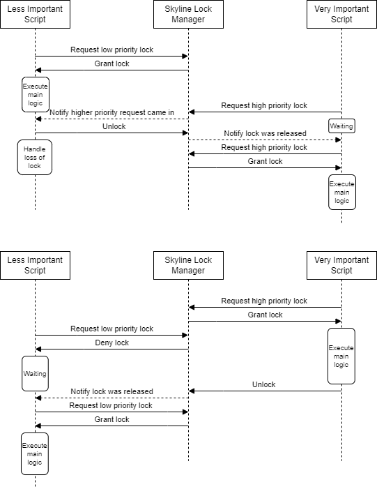

System with multiple lock priority levels
When a lock is requested, a priority level can be specified. This allows more important components to get a lock even when less important components already hold a lock for the same object.
The diagram below shows how this could be implemented.
Prioritized locking diagram
