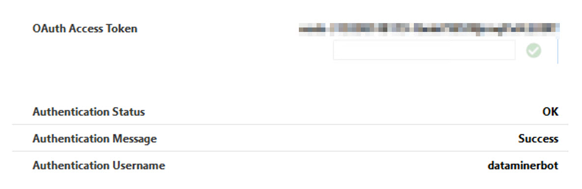

  8. Install the application in your workspace in order to receive the bot authentication token that can be used in the element.
  9. Copy the Bot User Oauth Access Token, and paste it in the OAuth Access Token parameter on the Authentication page of the Slack element in DataMiner.

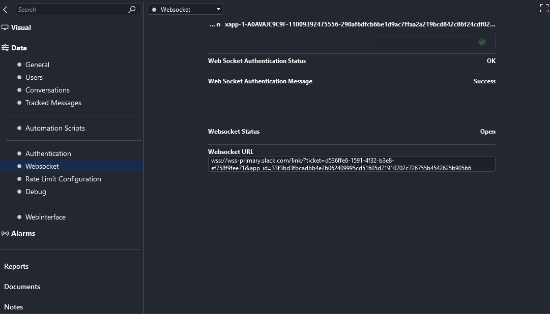

  10. Go to the Socket Mode page, and enable Socket Mode.
  11. Go to the App-Level Tokens section under the Basic Information page, and create a new token with the connections:write scope.
  12. Copy the new app-level token, and paste it in the App-Level Token parameter on the Websocket page of the Slack element in DataMiner.

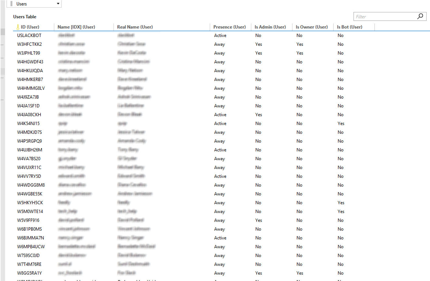

Users
This page contains a table with all users that are part of the Slack team.

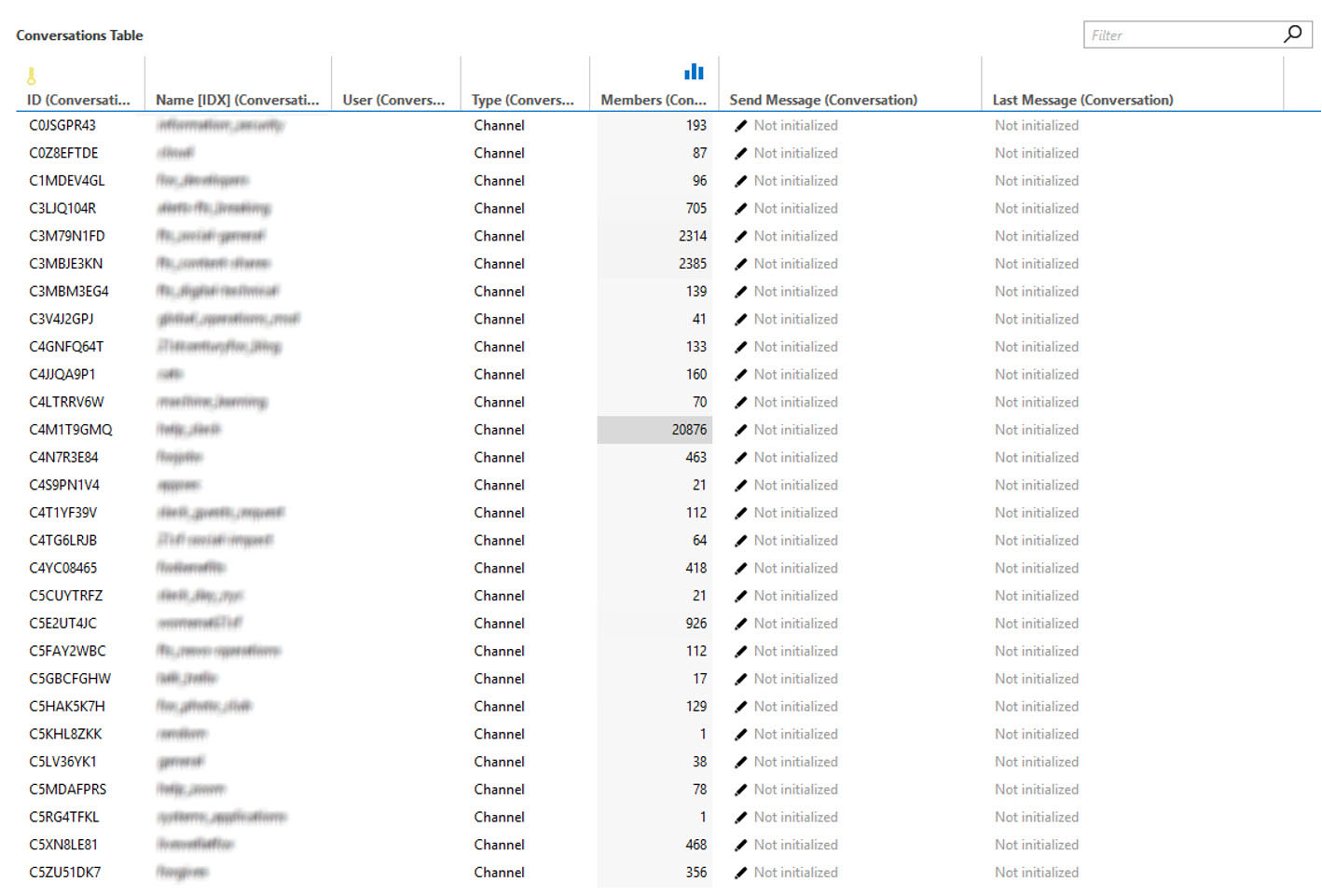

Conversations
This page contains a table listing all possible conversations (public channels, private channels, instant messaging) that messages can be sent to. The "Send Message" column allows you to quickly send a message to a specific conversation. The last received message is shown in the "Last Message" column.

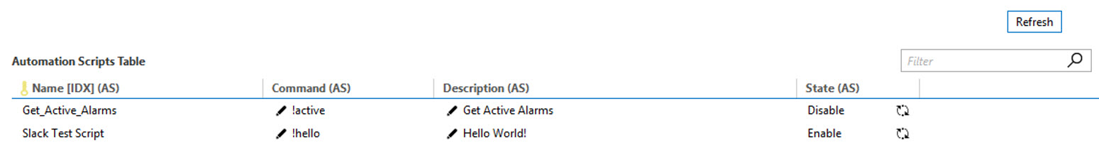

Automation Scripts
This page contains a table with all existing automation scripts in DataMiner that can be executed via commands in Slack.
To refresh the content of this table, use the Refresh button.
The Description column contains user-defined text that is presented when the list command is requested from a conversation.
In the Command column, a command can be assigned to each automation script. When a user sends one of these commands in one of the channels that include the bot, the connector will run the linked automation script. This allows the administrator to freely configure the name of the commands associated with each automation script.
The State column allows you to enable or disable the possibility to execute a particular script.
Only scripts that were adapted to be compatible with this Slack integration are shown in the table. In order for a script to be valid, it must have the following dummy and parameters:
  • Dummy SLACK: The Slack DataMiner element that is executing the script.
  • Parameter CONVUSERNAME: The end user name. This can be used by the script to reply with messages referring to the name of the Slack user that invoked a command.
  • Parameter CONVID: The ID of the Slack conversation in which the command was invoked.
  • Parameter SLACKARGUMENTS: The plain text after the command name that was provided by the Slack user when the command was invoked.

Authentication
On this page, the OAuth access token that should be used to communicate with the Slack API must be configured. The page also contains some parameters that display the current status of the authentication.
Websocket
On this page, the App-Level Token that should be used to connect to the Slack Web Socket must be configured. The page also contains some parameters that display the current status of the web socket connection.
