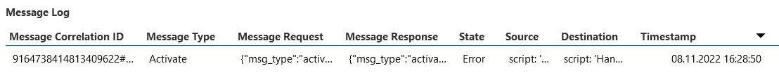

Any incoming job is registered in the Message Log table, where the primary key is the Job Message Correlation ID.
The possible values for the Type column are: Activate, Replace or Deactivate, whereas for the State column are: Error or OK.
Configuration
You can configure the number of rows of the Message Log table by using the "Maximum Number of Rows" or the "Keep Record for" parameters.
