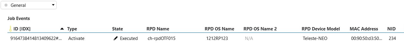

An incoming job is registered in the Job Events table, where the primary key is the Job Message Correlation ID.
The possible values for the Type column are Activate, Replace, or Deactivate. For the State column they are Executed or Cancelled.
