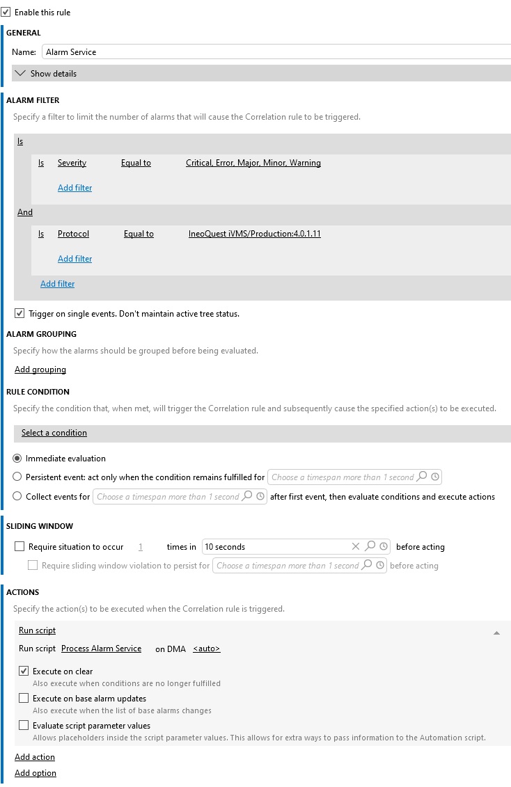

When the script has been imported, create a correlation rule that will execute the automation script whenever the Ineoquest iVMS generates or clears an alarm related to the video channels. The screenshot below illustrates how to do so.
For more information on the Correlation module, see DataMiner Correlation.

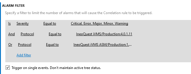

This range also introduces the possibility to choose elements that run the Ineoquest iVMS ASM connector. This means that the following change to the correlation rule is needed:
Alarm filter configuration

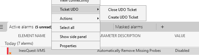

You can also disable the correlation rule that creates and closes the tickets, in order to do this manually instead. For this purpose, you need to save a HyperLinks.xml file in the C:\Skyline DataMiner folder and add the automation script Update Manual UDO Ticket on the DMA. After that, you just have to right-click the corresponding alarm and select Ticket UDO > Create/Close UDO Ticket as shown in the image below.
Ticket UDO menu
