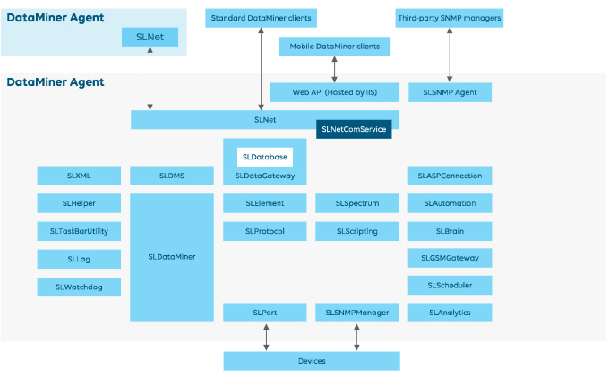

A DataMiner Agent hosts a number of separate but interacting processes.
Graphical overview of the processes running on a DataMiner Agent
The following overview clearly shows how the DataMiner Agent software is a collection of separate but interacting processes.
Overview of the DataMiner Agent processes
DataMiner Agent process overview
