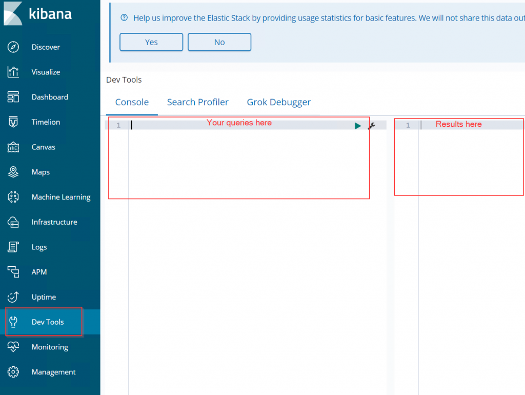

Entering queries
To enter queries, in the bar on the left, navigate to Dev Tools as indicated below:
Kibana example

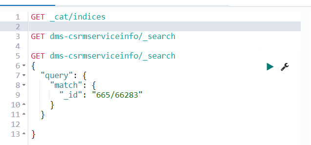

Queries in Kibana
The screenshot below illustrates what the queries will look like in Kibana. Note that there is no need to comment out any single query. Instead, you can run separate queries on their own by clicking the little triangle to the right of the query. Additionally, no semicolon is required after a query.
Kibana query examples

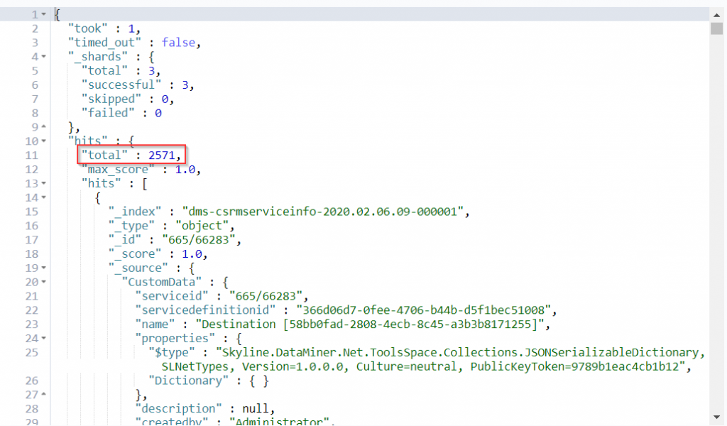

To find out how many records this index has, apply the following query:
GET dms-csrmserviceinfo/_search
This will return the number of records like this:
Kibana records
In the image above, you can see that the index in the example has only 2571 records, which means it is not too large.
