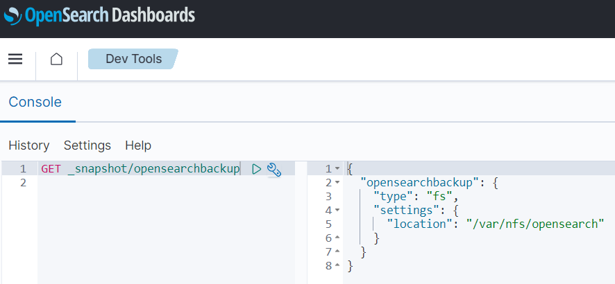

  2. Verify whether the repository has been created correctly by entering the following GET request using your chosen client application.
    GET _snapshot/opensearchbackup
    If the repository has been created correctly, the response will provide repository information.
    Example, using OpenSearch Dashboards as client application:
    Verify
    • "opensearchbackup": Name of your snapshot repository
    • "fs": A file system repository
    • "/var/nfs/opensearch": The path where all snapshots are stored
    For more information, see Get snapshot repository.

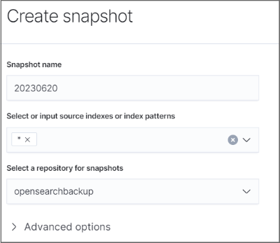

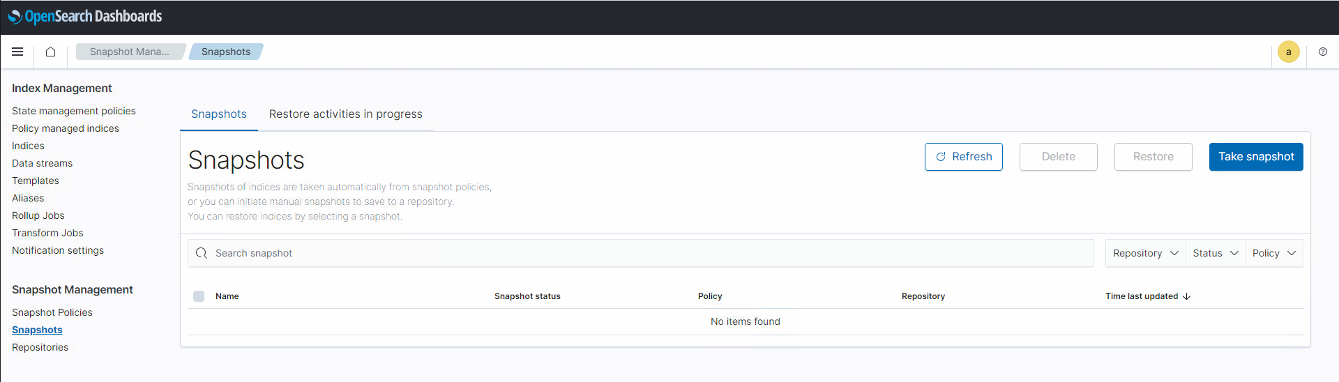

Taking a snapshot using OpenSearch Dashboards
  1. In OpenSearch Dashboards, click the hamburger button in the upper-left corner and select Snapshot Management. In the pane on the left, now select Snapshots to view an overview of all snapshots.
    OpenSearch Dashboards - Snapshot Overview
  2. Select Take snapshot in the upper-right corner.
  3. Specify the following details:
    • Snapshot name: The name of the snapshot
    • Select or input source indexes or index patterns: Enter an asterisk ("*")
    • Select a repository for snapshots: The repository you created in Creating a snapshot repository
    Save all changes by clicking Add.
  4. In the overview, you will now see your newly taken snapshot.

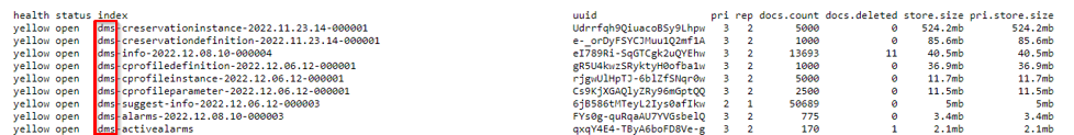

    • "dbprefix": The prefix specified in the DB tag for the indexing database in the DB.xml file (in the folder C:\Skyline DataMiner\)
      To find the prefix DataMiner puts in front of an index name, enter http://[IP address]:9200/_cat/indices in your browser's address bar. Replace "[IP address]" with your IP address. prefix
