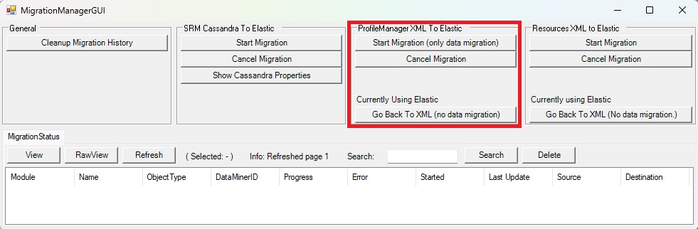

To migrate the profiles, you will need to use the SLNetClientTest tool. Note that while the tool mentions only "Elastic", it can also be used for a migration to OpenSearch.
Migration window in SLNetClientTest tool (version 10.3.2)
Warning
Always be extremely careful when using this tool, as it can have far-reaching consequences on the functionality of your DataMiner System.
  1. Connect to the DMS using the SLNetClientTest tool:
    1. In the SLNetClientTest tool, go to Connection > Connect.
    2. In the Connect window, under Authentication, select Explicit credentials and specify the credentials of an administrator user.
    3. Click the Connect button.
  2. In the Advanced menu, select Migration.
  3. In the ProfileManager XML to Elastic section, click the Start Migration button to start the migration wizard.
    • A window will show the migration actions that have been scheduled. If you close this window, the migration will continue in the background. To cancel the migration, click the Cancel Migration button.
    • In the MigrationStatus table in SLNetClientTest tool, the profile instances, definitions, and parameters rows will reflect the progress of the migration.
    • All profiles will be loaded from the Profiles.xml file on the DataMiner Agent where the migration was triggered. The Profiles.xml files of the other DataMiner Agents in the cluster are not migrated. This is not necessary, as the Profiles.xml file is synced in the cluster.
    • The profiles objects will be written to the indexing database.
    A snapshot of the Profiles.xml file will be migrated, which means that Profile Manager is not stopped during the migration and keeps keep working as expected. However, changes to profiles that are done during the migration will not be included in the migration, so avoid creating, updating, or deleting profile objects until the migration is complete and the system has switched to using the indexing database for profile information.
    The migration should not take more than a few minutes. During testing, migrating a Profiles.xml file of 100 MB in a system with a local Elasticsearch database took about 4 minutes.
  4. Check whether in the MigrationStatus table, the migration of profile instances, definitions, and parameters has the status completed, and there are no error messages.
    If you see errors, refer to the Troubleshooting section below.
  5. When the migration is complete, click the Create Configuration button to create the configuration file.
    If this button is not visible, that means you already have a configuration file. You can continue by clicking the Start using Elastic button to switch to indexing database storage.

Checking the storage type used by a DataMiner Agent
If you want to know which storage type a DataMiner Agent is currently using, open the migration window as detailed under Migrating from XML to the indexing database.
The current storage type is displayed in the ProfileManager XML to Elastic section, under the Cancel Migration button. It will either state Currently using XML or Currently using Elastic.
