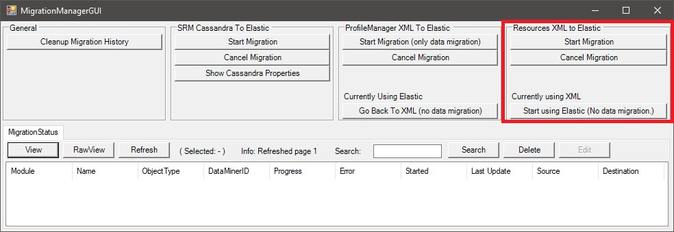

To migrate the resources, you will need to use the SLNetClientTest tool. Note that while the tool mentions only "Elastic", it can also be used for a migration to OpenSearch.
Migration window in SLNetClientTest tool (version 10.3.2)

  2. In the Advanced menu, select Migration.
  3. In the Resources XML to Elastic section, click the Start Migration button to start the migration wizard.
    The bookings that are currently running or will start in the next hour will be shown. Resource Manager will restart during the migration, which means these bookings can potentially be affected. No booking events will run while Resource Manager is down.
  4. Click Continue Migration.
    The custom properties of the resources and resource pools that are incompatible with an indexing database (see Allowed property names) will be shown, along with the conversion that will be automatically applied. If the Resources.xml file is corrupt, the properties cannot be collected. In that case, an error will be shown, and the migration cannot be started. If all found properties are compatible with the indexing database, the wizard will show No properties that need conversion were found.
  5. If you agree with the proposed conversion of the properties or no conversion is necessary, click Continue Migration to start the actual migration process. If you do not accept the conversion, click Cancel Migration.
    • A window will show the migration actions that have been scheduled. If you close this window, the migration will continue in the background.
    • The progress of the scheduled actions will be shown in the MigrationStatus table in SLNetClientTest tool, where a row will be created for the migration of resources and resource pools. These rows will be updated to reflect the progress of the migration.
    • All Resource Manager instances in the cluster will be stopped. If DataMiner cannot reach a Resource Manager instance for some reason, the migration will be canceled, and all Resource Manager instances will be notified to start up again without changing their storage type.
    • While the migration is in progress, a notice will be added in the Alarm Console. Once the migration is completed, the notice will be cleared and an information event will be generated, stating that the migration has finished.
    • All resources and resource pools will be loaded from the Resources.xml file on the DataMiner Agent where the migration was triggered. The Resources.xml files of the other DataMiner Agents in the cluster are not migrated. This is not necessary, as the Resources.xml file is synced in the cluster.
    • The properties (for resources and resource pools) and property definitions (for resource pools) will be converted if needed and written to the indexing database. Empty property names will be discarded at this stage, since they cannot be indexed in an indexing database. Empty property values will be replaced with an empty string.
    • When the migration for both resources and resource pools is completed, the configuration will automatically switch to indexing database storage, and the local Resource Manager (where the migration was triggered) will be initialized. Then all other Resource Manager instances in the cluster will be notified that they should start up and switch to indexing database storage.
  • The migration should not take more than half an hour. During testing, migrating a Resources.xml file of 1 GB in a system with a local Elasticsearch database took about 13 minutes.
  • You can cancel the migration process by clicking the Cancel Migration button in the Resources XML to Elastic section.
