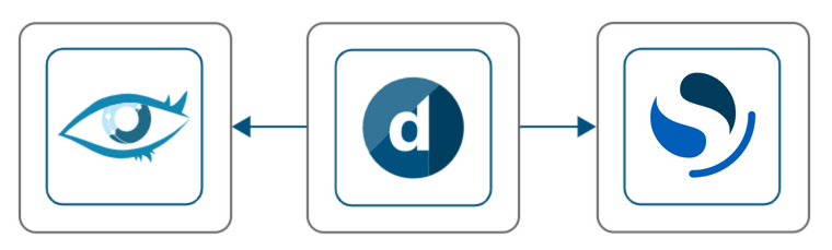

A DataMiner, Cassandra, and OpenSearch node, each running on dedicated machines

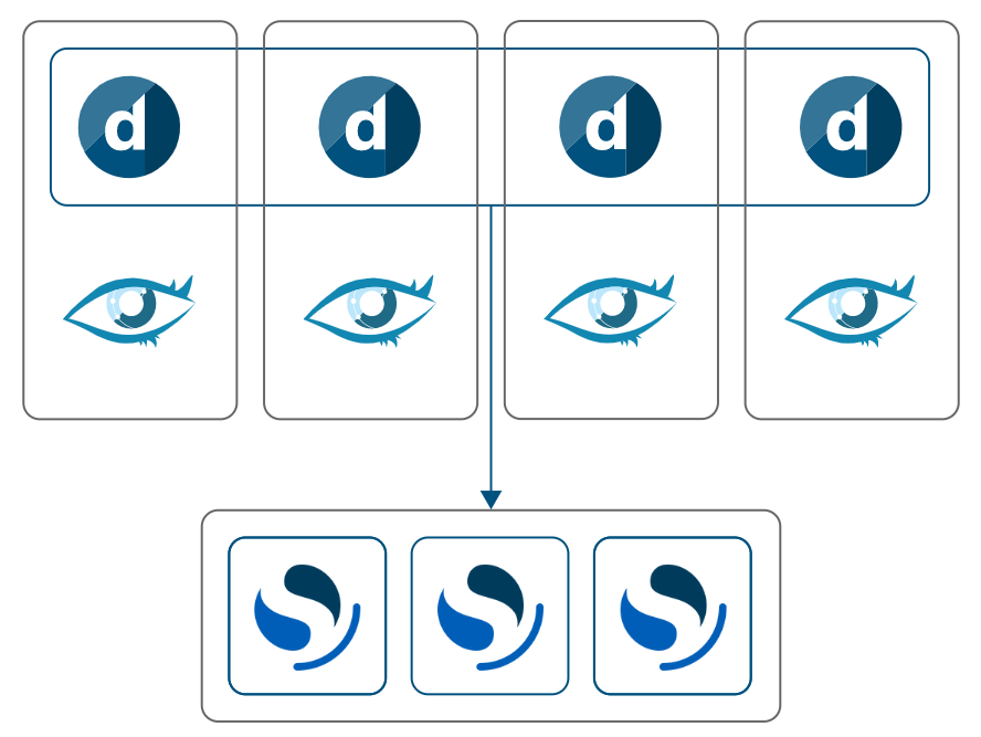

A DMS consisting of four DMAs, each with their own Cassandra database, and an OpenSearch cluster

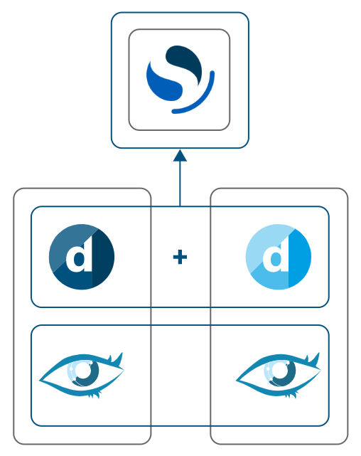

Failover pair with Cassandra database hosted on the same machines as DataMiner and a one-node OpenSearch database

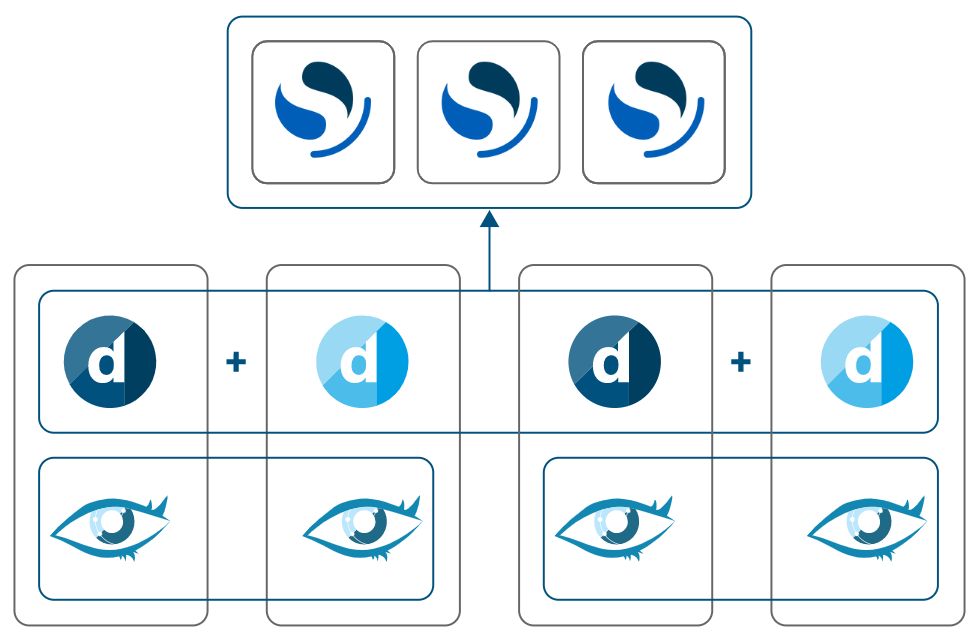

Two Failover pairs, each with two Cassandra nodes running on the same machines, and a three-node OpenSearch database for the entire DMS
