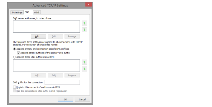

In older DataMiner Systems, one way of preventing both Agents from registering the virtual IP address, is the following:
  1. In the Advanced TCP/IP Settings of the network interfaces that will use virtual IP addresses, go to the DNS tab and clear the option Register this connection’s addresses in DNS.
    Advanced TCP/IP Settings window
  2. On the DNS server, add fixed records for both the main and the backup DMA. Also add an extra entry for the virtual IP address.
