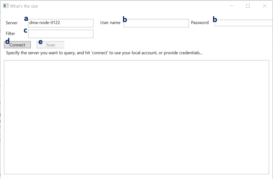

  3. In the Server field (a), specify the IP or name of a DataMiner node.
  4. In the User name and Password field (b), specify the credentials of an account that has access to the DMS. If you are running the tool using an account that has access to the DMS, you do not need to fill these in.
    The tool only counts the elements that you have access to with the user credentials you are using. If you want to count your entire setup, make sure you use user credentials with sufficient rights to access all elements in the DMS.
  5. Click the Connect button (d).
    If you encounter a Skyline.DataMiner.Net.Exceptions.DataMinerCommunicationException:Possible version conflict exception, copy the SLNetTypes.dll and ICSharpCode.SharpZipLib.dll files from C:\Skyline DataMiner\Files to the directory where the WhatsTheSize.exe file is located.
  6. Optionally, specify (part of) a protocol or element name in the Filter box (c) in case you only want to count specific protocols or elements. Only protocols or elements that contain the text specified in the box (case-insensitive) will be taken into account.
    For example, if your filter is “ird”, only elements with “ird” in the element name or protocol name will be included.
  7. Click the Scan button (e).

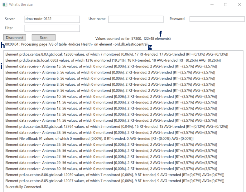

  8. Wait until the program is finished. During the scan, you will see:
    • How many elements have been scanned and the total number of elements to scan (f)
    • The progress within the current element (g)
    • The total time the scan has taken up to now (h)
    • For every element that is scanned (i):
      • The number of metrics
      • The number of monitored and trended parameters

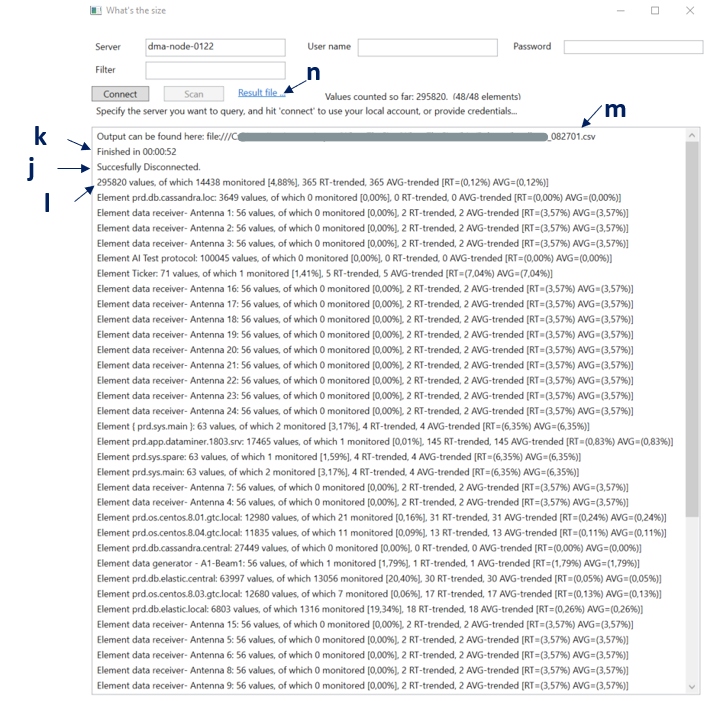

  9. When the tool is finished, you will see:
    • The tool disconnecting from your DMS (j)
    • How long the scan took (k)
    • The total number of metrics counted (l)
    • The path where the output file is stored (m) and a link to that file (n)
DataMiner Size tool: Initial window to start scanning
DataMiner Size tool: During the scan
DataMiner Size Tool: After the scan
