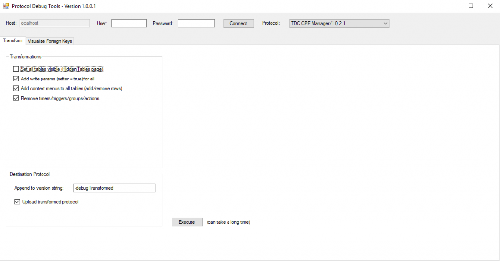

Clicking the Execute button with the configuration below will add a protocol “TDC CPE Manager/1.0.2.1-debugTransformed” on the DMA.

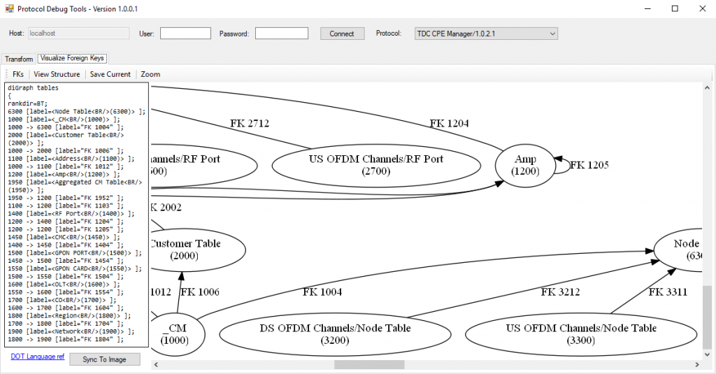

In the example below, you can see the visualization of the foreign keys of a protocol, with the text box on the left that can be used to remove tables that should not be included:

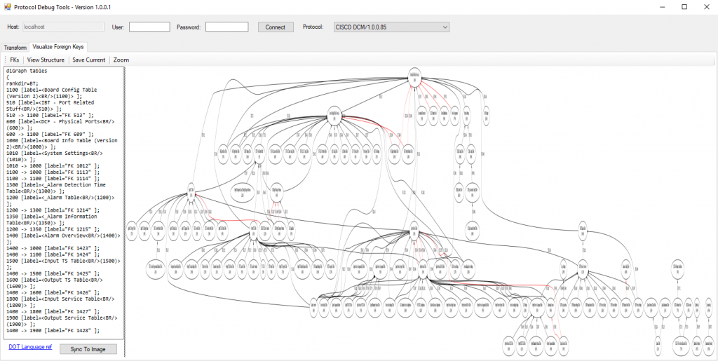

In the example below, red lines show foreign key relations that are not explicitly mentioned in the relations defined in the protocol:

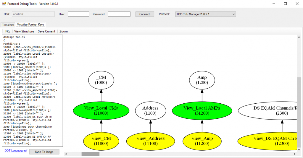

The example below shows how the view structure is visualized, with direct view tables indicated in yellow and views indicated in green:
