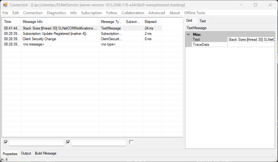

Properties tab
The Properties tab shows an overview of the different messages that have been sent and received, with the time they were sent and the time it took to get a response.
When you select a message in the list, the pane on the right shows more detailed information. With the Grid and Text tabs at the top of that pane, you can switch between two different ways of viewing this information.
At the bottom of the tab, three filter boxes are available. The leftmost box will highlight messages in yellow, the middle box highlights them in cyan, and the box on the right allows you to filter based on a regular expression. Note that the box on the right is only available from DataMiner 10.5.11/10.6.0 onwards, and it should only be used when no new messages are expected to arrive.

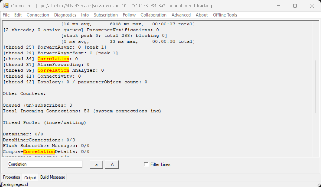

Output tab
The Output tab displays detailed results from commands sent with the tool.
A filter box is available at the bottom. Any text you enter in the box will be highlighted in the pane above. If the Filter Lines box is selected, only the lines containing text that matches the filter will be shown.
With the two buttons next to the filter box, you can decrease and increase the font size of the text.

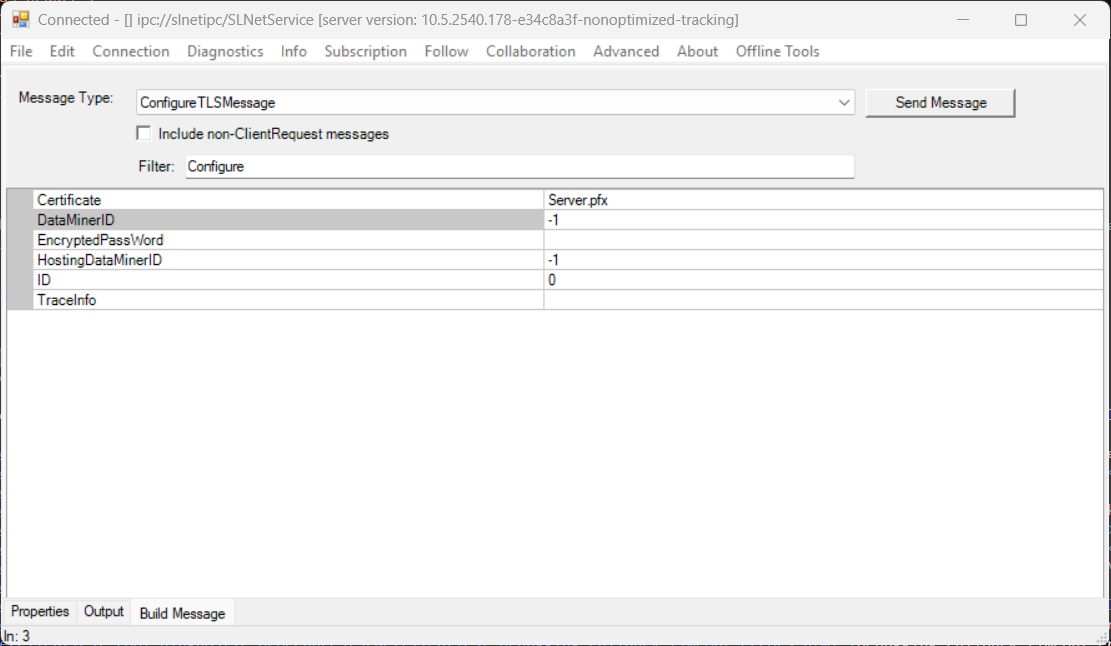

Build Message tab
In the Build Message tab, you can send a message to the DataMiner Agent you are currently connected to, by selecting the message in the box at the top, configuring the necessary parameters in the main pane below, and then clicking Send Message.
If you enter text in the filter box below the Message Type box, only the messages matching that filter will be shown. This is a quick and easy way to find the message you are looking for in the box.
For more details about specific messages, refer to diagnostic procedures and advanced procedures in this documentation.
