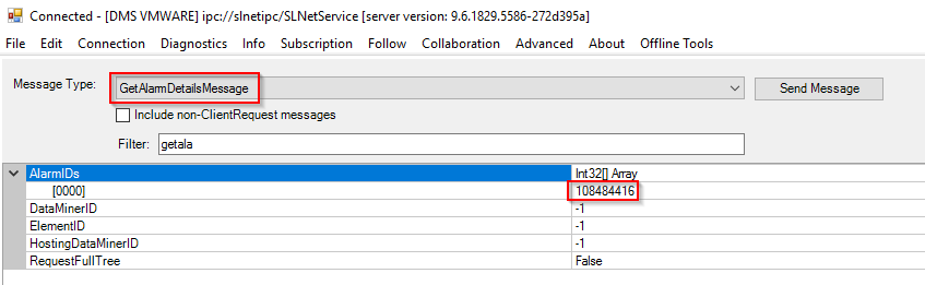

  4. In the Message Type dropdown list, select GetAlarmDetailsMessage.
  5. Next to the Int 32[] Array for AlarmIDs, click the ... button.
  6. Click Add, fill in the alarm ID you retrieved earlier, and click OK.
    Getting the alarm details
    Example of getting the alarm details in DataMiner 10.3.3
  7. Click Send Message.

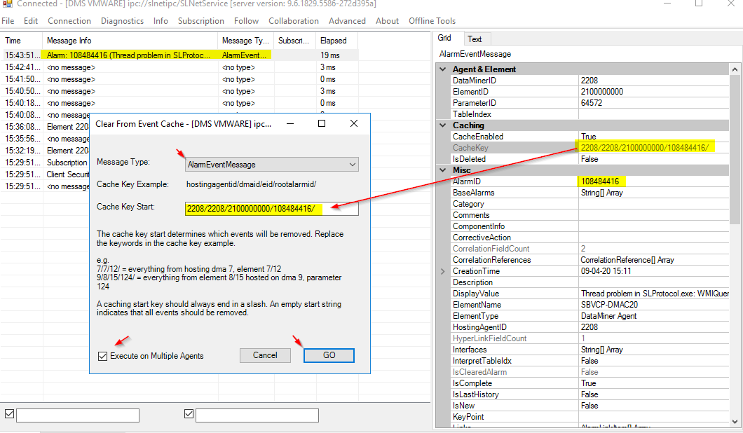

  8. In the Properties tab, select the latest message, and then select the Grid tab on the right.
  9. Copy the value next to CacheKey.
  10. In the menu at the top, select Advanced > Clear From > Event Cache.
  11. In the pop-up window, make sure Message Type is set to AlarmEventMessage and Execute on Multiple Agents is selected.
  12. Paste the value you have copied in the Cache Key Start box, and click GO.
    Clearing alarms from the event cache
    Example of clearing an alarm from the event cache in DataMiner 10.3.3
