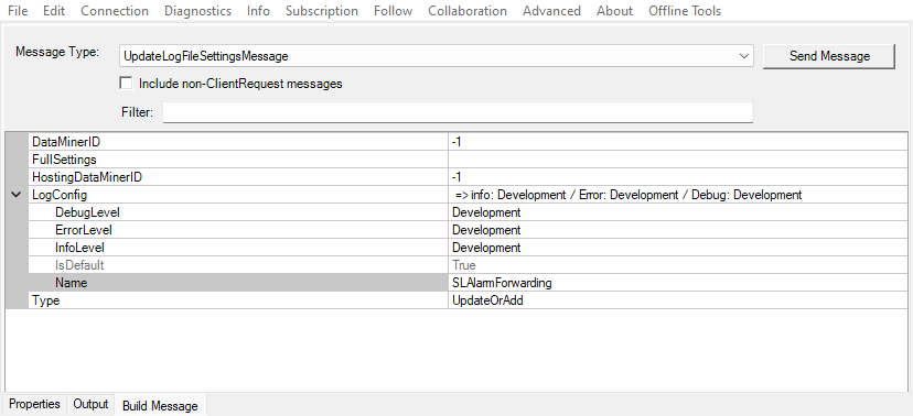

  2. Go to the Build Message tab of the main window of the SLNetCLientTest tool.
  3. In the Message Type dropdown list, select UpdateLogFileSettingsMessage.
  4. In the box next to LogConfig, click the "..." button.
  5. Expand LogConfig, select the DebugLevel, ErrorLevel, and InfoLevel you want, and specify the name of the log file.
    For example:
    UpdateLogFileSettingsMessage configuration in SLNetClientTest tool
    UpdateLogFileSettingsMessage configuration in SLNetClientTest tool in DataMiner 10.3.6
