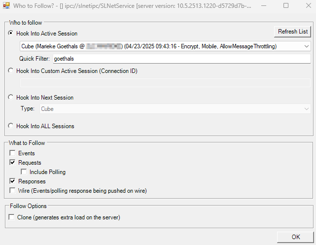

Following a DataMiner Cube session
Below you can find how you can activate follow mode specifically to follow a DataMiner Cube session for troubleshooting purposes. This is similar to what is outlined above, but here the specific options are described that you need to select for the purpose of following Cube only.
  2. In the menu bar at the top, select Follow > Follow.
  3. In the Who to follow window:
    1. Select Hook Into Active Session and select the Cube session.
    2. In the Quick Filter box, specify the name of the user whose Cube session you want to follow.
    3. Under What to Follow, select Requests and Responses.
    4. Click OK.
    Who to Follow window
  4. In DataMiner Cube, reproduce the issue you are trying to troubleshoot.
  5. Save a transcript by going to File > Dump > Save.
