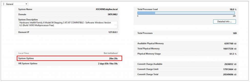

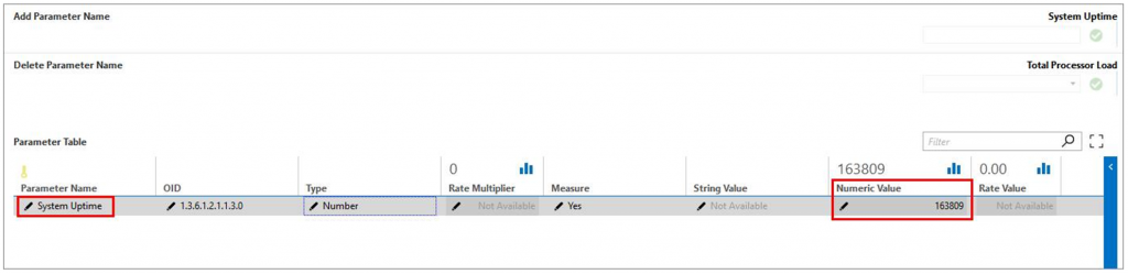

For example, below you can find two elements that monitor a laptop computer ("System Uptime" is highlighted). The first one uses the Generic SNMP connector, while the second one uses the Microsoft Platform SNMP connector.
Dedicated connector/connector
Dedicated connector
