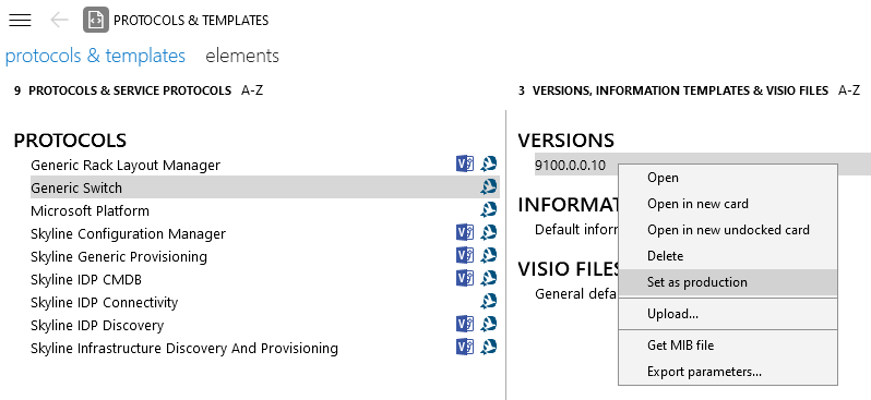

  1. Deploy the connector to start from:
    1. Deploy the latest version of the Generic Switch connector from the Catalog.
    2. Make sure the latest version is set as production.

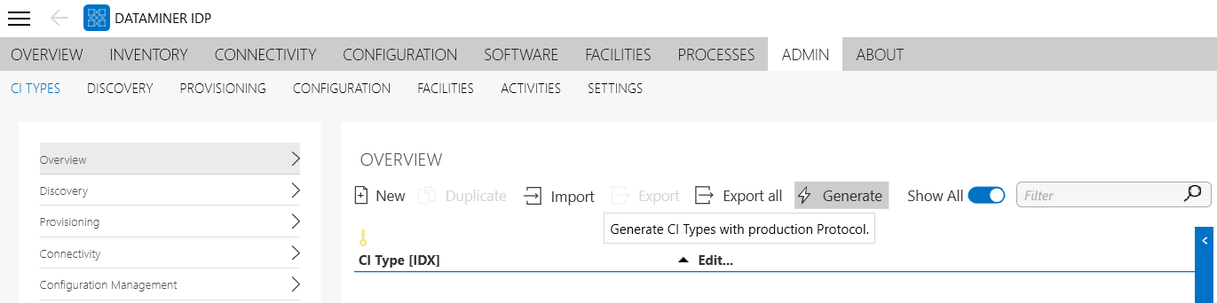

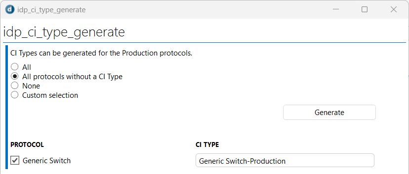

  2. Generate the CI Type:
    1. Open the IDP app.
    2. Go to Admin > CI Types.
    3. Above the table on the right, click Generate to start the wizard.
      Start to generate the CI Type script
    4. In the wizard, select the connector and click Generate.
      Select the connector
    5. Click Finish to close the wizard.
    6. Switch off the Show All button in the upper-right corner to locate the generated CI Type more easily.

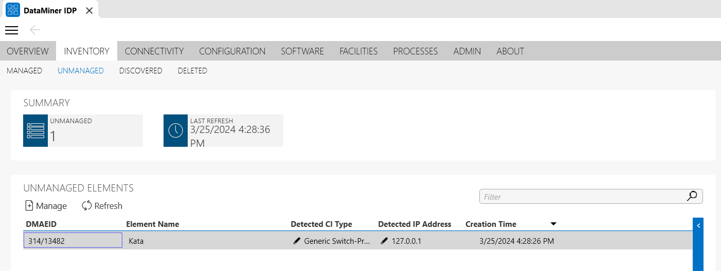

  2. In the IDP app, go to Inventory > Unmanaged.
  3. Click Refresh to refresh the table.
    Make sure Detected CI Type contains the generated CI Type. If it does not, confirm that the element was created with the production version.
  4. Select the recently created element, and click Manage.
    Unmanaged element

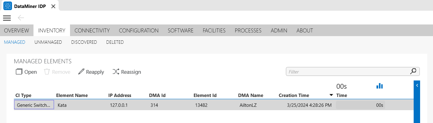

  5. Go to Inventory > Managed to confirm the element is now managed by IDP.
    Managed element

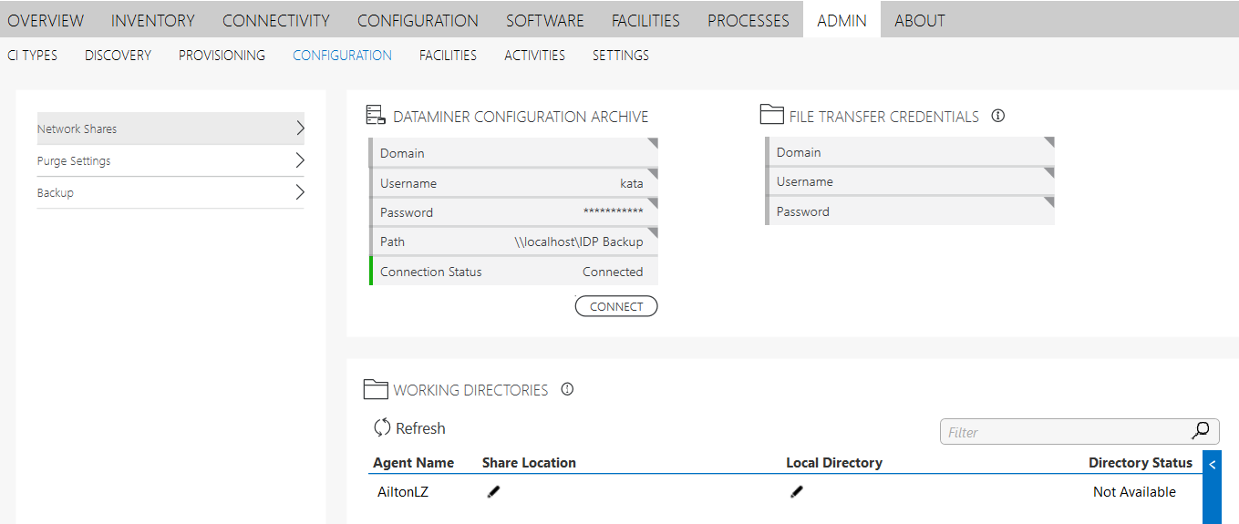

Step 3: Set up the configuration archive
For IDP to store the configurations, it needs to access a local folder or a shared folder.
  1. In the DataMiner IDP app, go to Admin > Configuration.
  2. Under DataMiner Configuration Archive, specify the settings to access the local or shared folder.
    • Click the triangle button in the top right corner to specify a value for each setting.
    • Specify the credentials for a user account that has access to the specified path.
    Setup configuration archive credentials
  3. Click Connect.

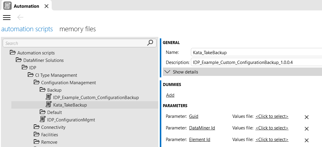

When IDP is installed it comes with an example script on how to retrieve the configuration and send it to IDP. You will now need to duplicate this script and change it to retrieve the parameter values from the element created in step 2.
  1. Duplicate the example configuration backup script:
    1. Go to the Automation module.
    2. Expand the folders until you reach DataMiner Solutions > IDP > CI Type Management > Configuration Management > Backup.
    3. Within this folder, duplicate the IDP_Example_Custom_ConfigurationBackup script, and rename it.
      Duplicated script
  2. Update the script to retrieve the parameter values from the element you created earlier:
    1. Open the script.
    2. Go to the GetDeviceFullBackupAsText function.
    3. Change the function to retrieve the values from parameters 502 (System Contact) and 504 (System Location).
      private static string GetDeviceFullBackupAsText(IActionableElement element)
          StringBuilder builder = new StringBuilder();
          builder.Append(Convert.ToString(element.GetParameter(502)));
          builder.Append("\n");
          builder.Append(Convert.ToString(element.GetParameter(504)));
          return builder.ToString();
      Note that the above-mentioned parameters 502 and 504 are parameters of the suggested connector. If you have chosen another connector, you should adapt these parameters accordingly.

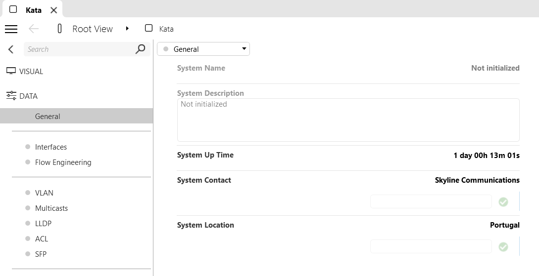

  3. Open the element you created in step 2, and assign values to parameters 502 (System Contact) and 504 (System Location).
    Set parameter values

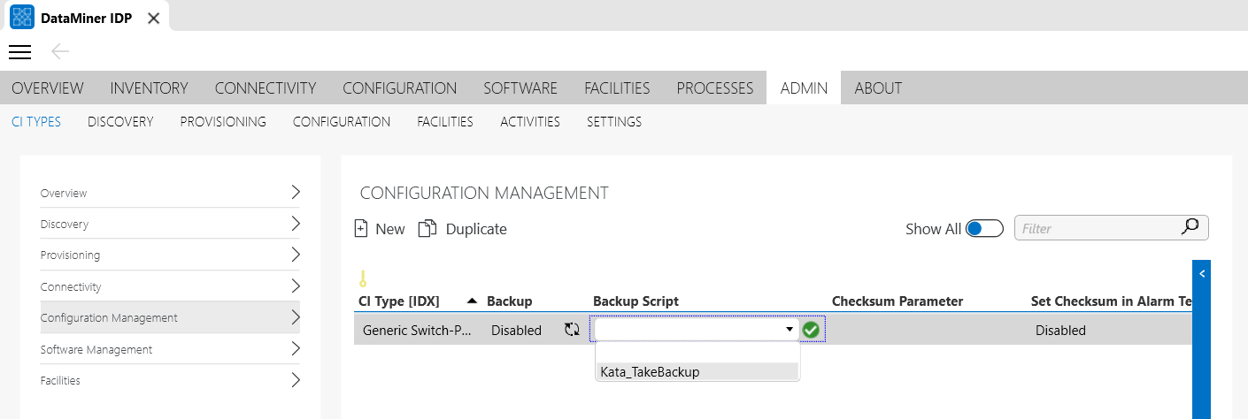

  2. Go to Admin > CI Types > Configuration Management.
  3. Select the backup script.
    If you cannot see the script in the dropdown, go to Admin > Settings and click the refresh button for the Backup Script Folder setting.
    Refresh backup script folder

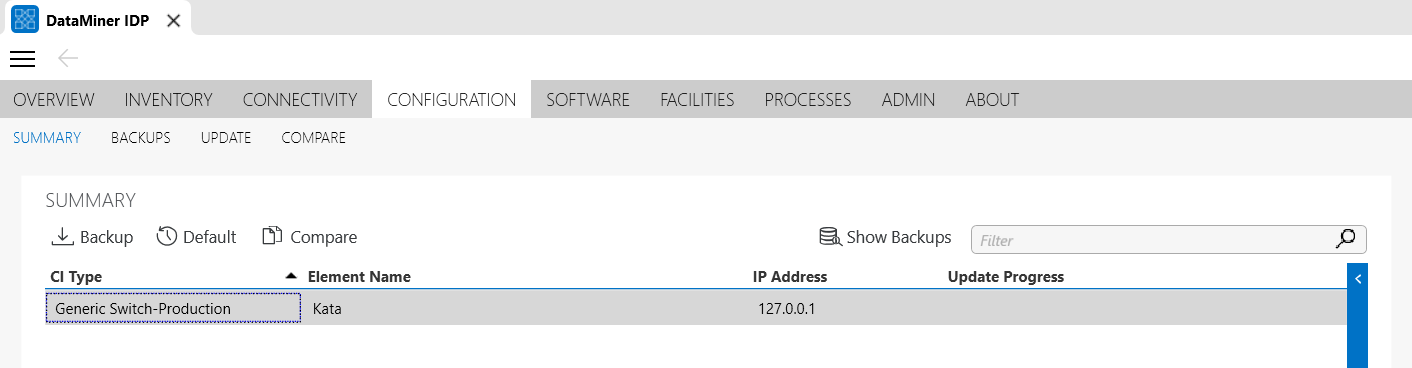

  4. Go to Configuration > Summary.
  5. Select the element, and click Backup.
    Run the script

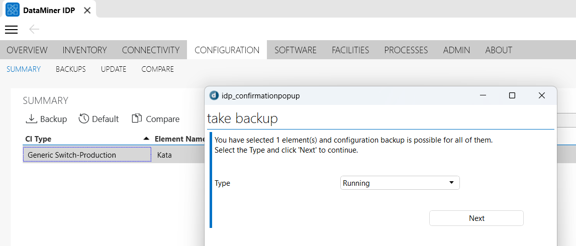

    This will open a wizard.
  6. Select a type (e.g., Running), click Next, and then click Finish.
    Confirmation pop-up script

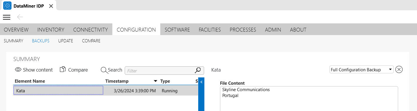

  7. Select the element again, and click Show backups.
  8. Select the recent backup, and click Show content.
    Backup content
Congratulations, you have saved your first device configuration with IDP.
