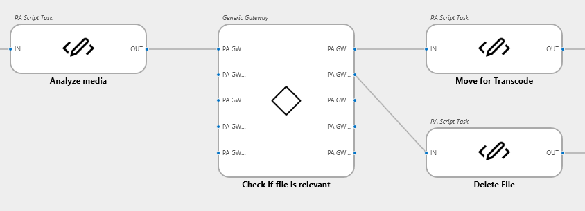

For non-linear processes, which contain more than one branch, gateways can be used. The behavior of a gateway is defined by so-called routing rules.
A gateway is a function with 5 inputs and 5 outputs. Routing rules indicate the condition to generate one or multiple tokens at one or several outputs of the gateway.
Generic Gateway
Function inputs are numbered from 1 to 5 and function outputs from 11 to 15. Those numbers are used during the configuration of the gateway.
Extending a process definition with a gateway
To integrate a gateway in a process:
  1. In the Process Automation app, extend the process definition with a Generic Gateway function.
  2. Drag the Generic Gateway function from the functions sidebar to the workspace and connect it to the relevant tasks/functions.
    Make sure the entry point of your process is still a start event and the end point is an end event.
  3. Build a JSON string representing the routing rules. See routing rules.
  4. In the Profiles module, create a profile instance that applies the PA GW profile definition and store the serialized routing rules in the PA GW RoutingRules parameter.
  5. In the Process Automation app, launch the process definition configuration wizard and select the previously created profile instance when you configure the gateway node.
