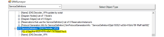

    • A service definition GUID
      Example of service definition GUID in SLNetClientTest tool

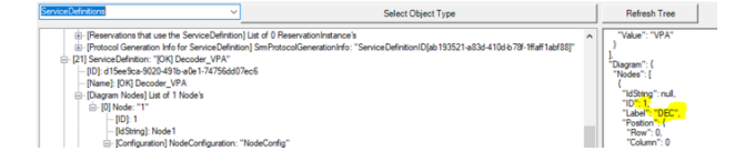

    • A node ID
      Example of node ID in SLNetClientTest tool

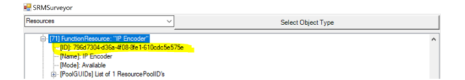

    • A resource GUID
      Example of resource GUID in SLNetClientTest tool

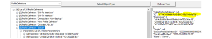

    • A profile definition GUID
      Example of profile definition GUID in SLNetClientTest tool

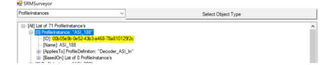

    • A profile instance GUID
      Example of profile instance GUID in SLNetClientTest tool
