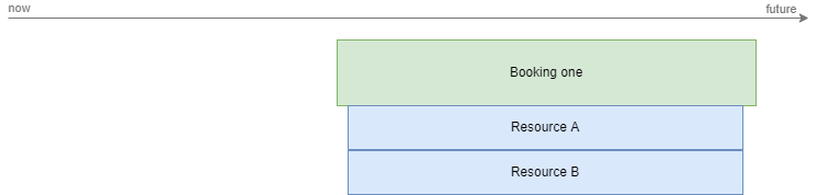

Concurrency conflict
Consider a system that has a booking with two resources Resource A and Resource B. Each resource in this system has a maximum concurrency of one, so it can only be used by one booking at the same time.
Quarantine concurrency example before

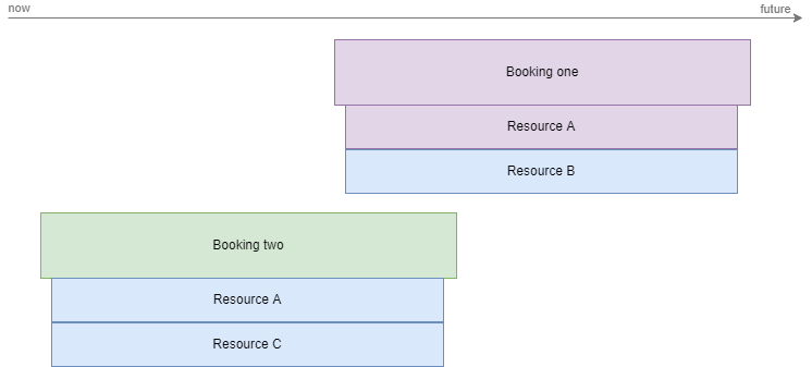

If a second booking is added to the system that overlaps with the first booking and that also wants to use Resource A, there will be a scheduling conflict. Resource A does not have enough concurrency to support the second booking. If the addition of the second booking is forced anyway, Resource Manager will resolve the conflict as follows:
Quarantine concurrency example result
In the diagram above, Booking one has been moved to quarantine, because it has the lowest priority (see Quarantine priority). Booking one will not start until the quarantine conflict is resolved. However, Resource B remains assigned to Booking one, which means that if another booking is created that overlaps with Booking one and that tries to use Resource B, another scheduling conflict will arise.

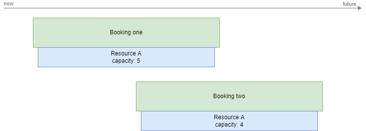

Capacity conflict
Consider a system that has two existing bookings in the confirmed state, each using a resource Resource A. Resource A has a concurrency of 10, so it can be used by 10 bookings at the same time, and it has a capacity defined with a maximum bookable value of 10.
Quarantine example before

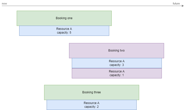

If a third booking is added as configured below, there is not enough capacity on Resource A to support this booking. If the addition of Booking three is forced anyway, Resource Manager will resolve the conflict as follows:
Quarantine example result
In the diagram above, Booking two has been moved to quarantine, because it has the lowest priority (see Quarantine priority). Resource A is still partially assigned to Booking two, because only the capacity necessary to resolve the conflict has been moved to quarantine. Since Resource A has a capacity of 10, only 1 capacity needed to be moved.
