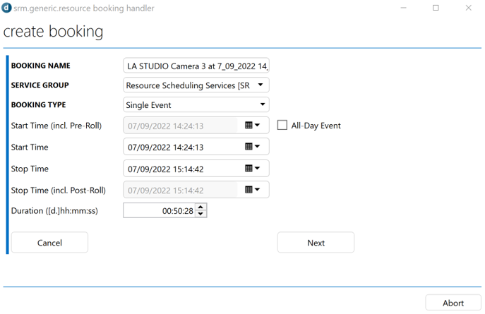

When a user runs the wizard, they will first need to specify the name and timing for the booking.
Step 1 of the resource scheduling wizard

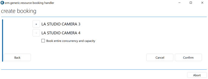

In the next step of the wizard, they can optionally provide capacity values. Alternatively, if no other overlapping should be created on the resource, they can book the entire resource.
Step 2 of the resource scheduling wizard
After they click Confirm, the booking will be created.
