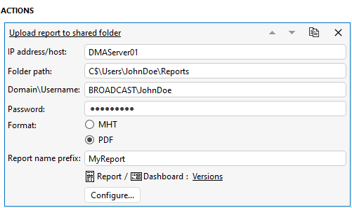

Example 2
User JohnDoe, belonging to the BROADCAST domain, wants a scheduled task to upload a report or dashboard named Versions to a folder on server DMAServer01, C:/Users/JohnDoe/Reports.
The folder path must be converted to a UNC path, C$\Users\JohnDoe\Reports, as shown in the image below.
Example 2 configuration
Configuration in DataMiner Cube 10.6.2

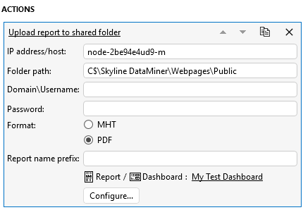

Example 3
A user wants to upload a PDF report or dashboard to local folder C:/Skyline DataMiner/Webpages/Public of their DaaS system, with hostname node-2be94e4ud9-m.
The credentials can be skipped in this case.
Example 3 configuration

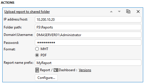

Example 4
A user wants to upload a report or dashboard to a folder on the F: disk of a server with IP 10.200.10.20 (F:/Reports), using an Administrator account.
Example 4 configuration
