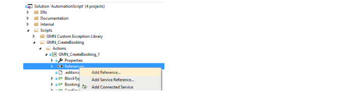

  3. Import the library into the other scripts to prevent compilation errors:
    1. Right-click the references of the solution and select Add Reference.
      Add Reference option
    2. Select the library script under Projects and click OK.
