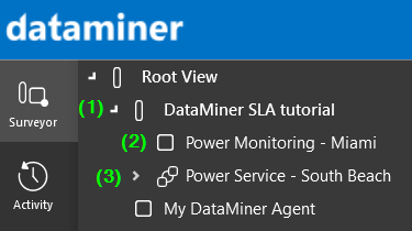

  3. Open DataMiner Cube and check whether the following items have been added to your DataMiner Agent:
    • A view named "DataMiner SLA tutorial" (1)
    • An element named "Power Monitoring - Miami" (2)
    • A service named "Power Service - South Beach" (3)
    If this is the case, the package has been successfully deployed.

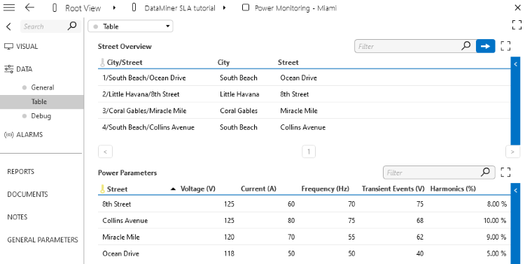

    On the Data > Table page of the element, you will see that the Street Overview and Power Parameters tables contain pre-provisioned data:

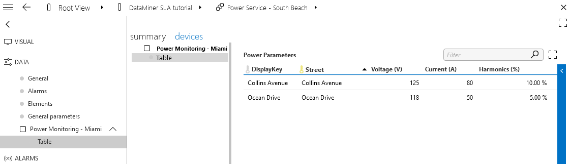

    On the Data > Power Monitoring - Miami > Table page of the service, you will see that the Power Parameters table already contains two entries.
    Service power parameters

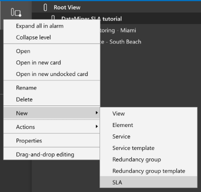

  1. In the Surveyor, right-click the DataMiner SLA tutorial view and select New > SLA.
    Create SLA
    A card will open.

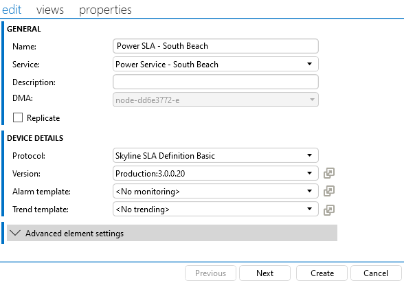

  2. Specify the following information:
    • Name: Power SLA - South Beach
    • Service: Power Service - South Beach
    • Protocol: Skyline SLA Definition Basic
    • Version: Production
    New SLA screen
  3. Click Create to add the SLA.

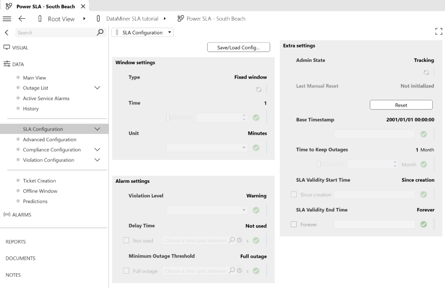

  1. Navigate to the Data > SLA Configuration page of your SLA.
  2. Configure the following parameters:
    • Window settings
      • Type: Fixed window
      • Time: 1
      • Unit: Minutes
    • Alarm settings
      • Violation Level: Warning
      • Delay Time: Not used
      • Minimum outage threshold: Full outage
    • Extra settings
      • Admin State: Tracking
      • Base Timestamp: 2001/01/01 00:00:00
      • Time To Keep Outages: 1 Month
      • SLA Validity Start Time: Since creation
      • SLA Validity End Time: Forever
    To save all changes simultaneously, click Save all in the lower-right corner.
    SLA configuration

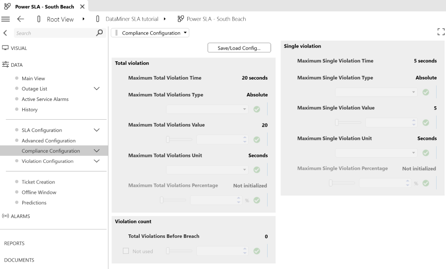

  3. Navigate to the Data > Compliance Configuration page of your SLA.
  4. Configure the following parameters:
    • Total violation
      • Maximum Total Violations Type: Absolute
      • Maximum Total Violations Value: 20
      • Maximum Total Violations Unit: Seconds
    • Violation count
      • Total Violations Before Breach: 0
    • Single violation
      • Maximum Single Violation Type: Absolute
      • Maximum Single Violation Value: 5
      • Maximum Single Violation Unit: Seconds
    Compliance configuration

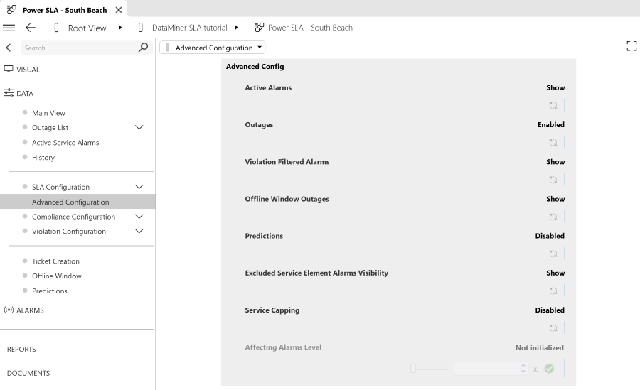

  5. Navigate to the Data > Advanced Configuration page.
  6. Configure the following parameters:
    • Active Alarms: Show
    • Outages: Enabled
    Advanced configuration

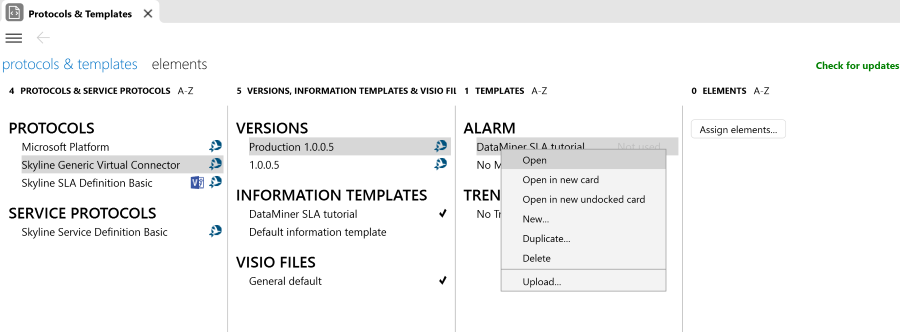

  1. In the Cube sidebar, go to Apps > Protocols & Templates.
  2. Under Protocols, select Skyline Generic Virtual Connector.
  3. Under Alarm, right-click DataMiner SLA tutorial and select Open.
    Open DataMiner SLA tutorial alarm template

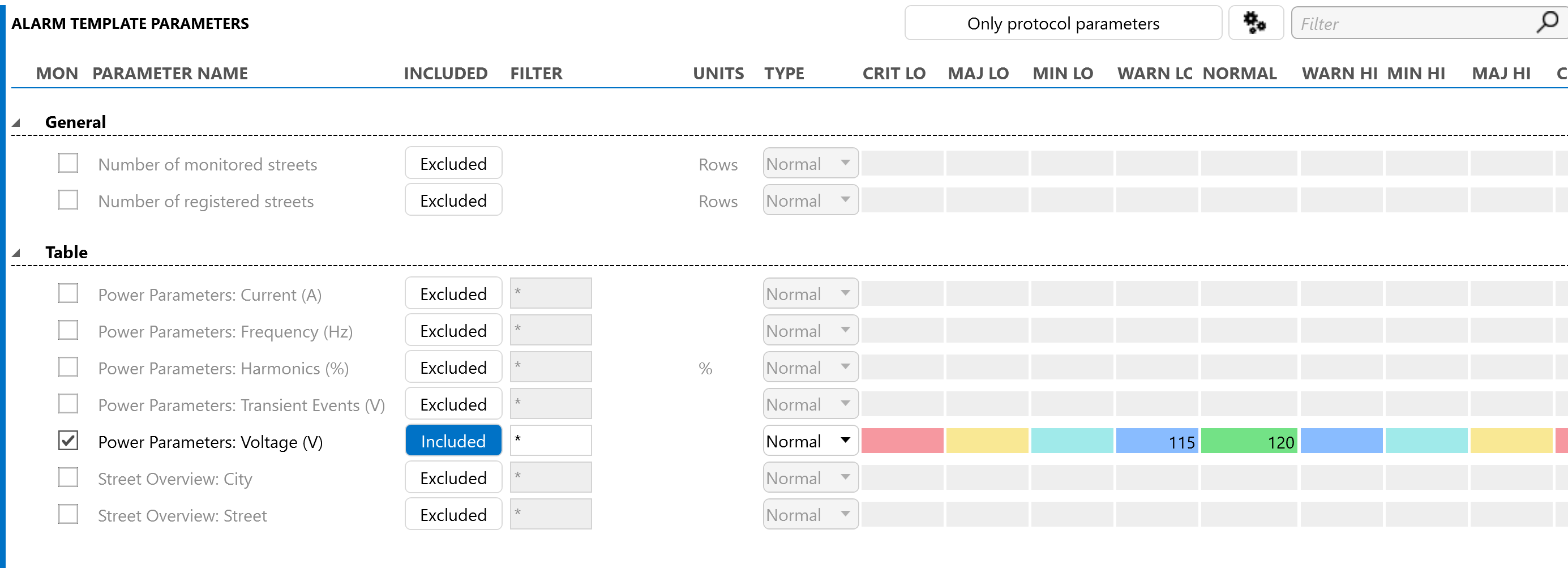

  4. Configure the alarm template:
    1. Under Table, set the Power Parameters: Voltage (V) parameter to Included.
    2. Configure the following alarm thresholds:
      • In the WARN LO column, enter 115.
      • In the NORMAL column, enter 120.
      Configure DataMiner SLA tutorial alarm template
    3. Click Apply and then OK.

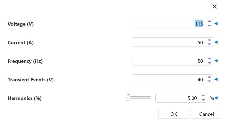

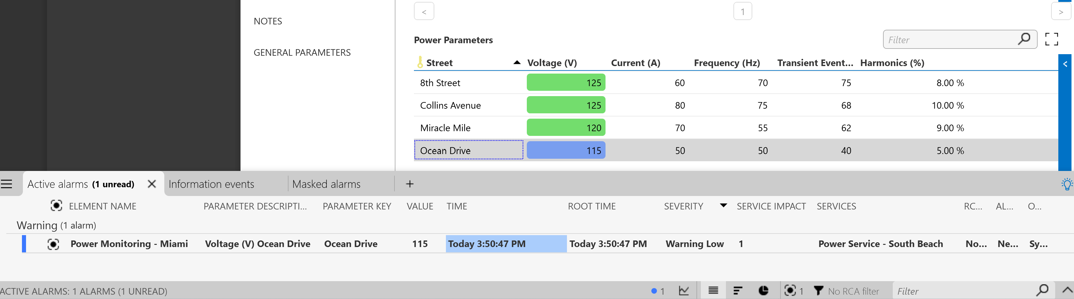

  7. Generate an alarm to verify whether the alarm template was correctly configured.
    1. In the Surveyor, select the Power Monitoring - Miami element.
    2. Go to the DATA > Table page, right-click the Ocean Drive entry in the Power Parameters table, and select Edit item.
    3. Lower the Voltage to 115.
      Generate a Voltage alarm
    4. Click OK.
    The Power Parameters table on the DATA > Table page of your element will now show an alarm in the Voltage column of the Ocean Drive entry. In the Alarm Console, you will see an alarm of severity Warning Low for the Power Monitoring - Miami element.
    Voltage alarm

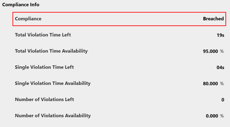

  1. Go to the DATA > Main View page of the Power SLA - South Beach SLA element.
    Under Compliance Info, you will see that Compliance is now set to Breached due to the simulated Voltage alarm.
    General SLA metrics
    It may take a few seconds before the compliance status changes from Compliant to Breached.

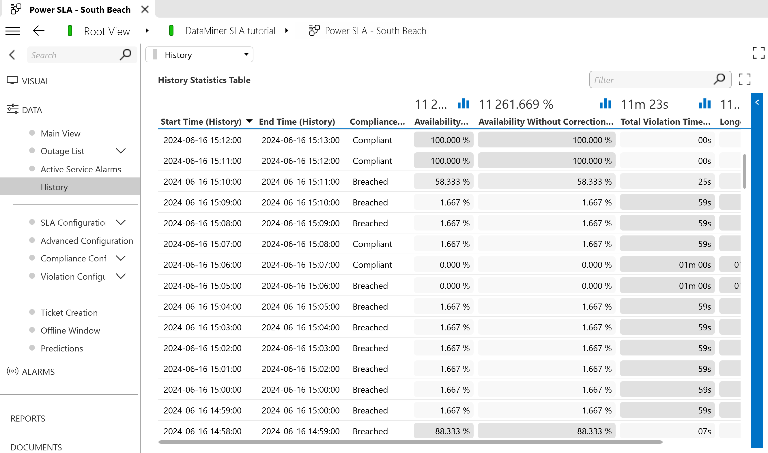

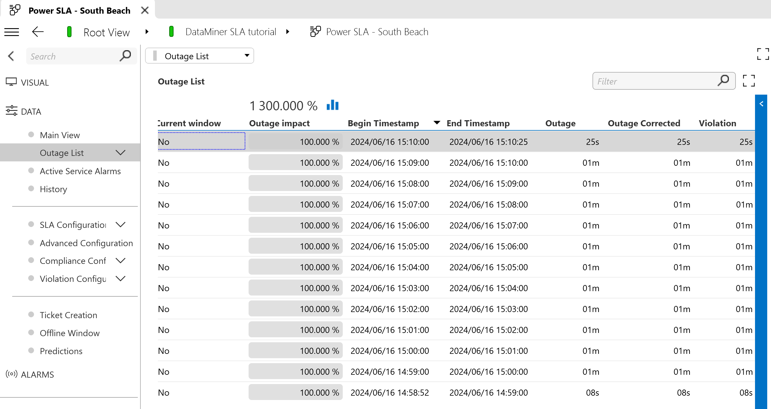

  4. Go to the DATA > Outage List page of the SLA.
    On this page, you will find a history of SLA compliance metrics.
    SLA outage list
    SLA history statistics
