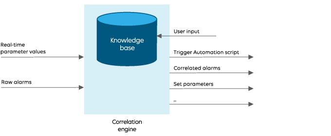

About DataMiner Correlation
DataMiner Correlation automatically analyzes raw alarm information and real-time parameter values, and acts upon that information according to the rule sets you define in its knowledge base. It is not only capable of detecting single events, but also persistent and recurring events.
Based on the rules set by the user, DataMiner Correlation can create correlated alarms or send notifications via text message or email, so that operators are informed of certain events. It can also trigger automation scripts, so that automatic countermeasures are possible in case of emergency or preventive actions in case of emerging issues.
Correlation engine concept

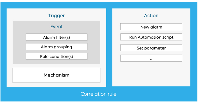

Correlation rules: basic concept
Each of the correlation rules in the knowledge base consists of:
  • A trigger, which determines when the rule is applied.
  • An action, which determines what happens when the rule is applied.
The trigger consists of:
  • An event that has to occur to trigger the rule.
  • A mechanism, i.e., the behavior of the event that will trigger the rule, e.g., the event recurs a particular number of times.
The event is a combination of:
  • One or more alarm filters (optional): These limit the number of alarms that will be taken into consideration for the correlation rule.
  • Alarm grouping (optional): This combines alarms matching the same criteria into separate correlated alarms. For example, when alarms are grouped per element, one correlated alarm is created per element.
  • Rule conditions: These conditions determines when the correlation rule is triggered. Ideally, a correlation rule should always contain at least one condition.
Correlation rule concept
