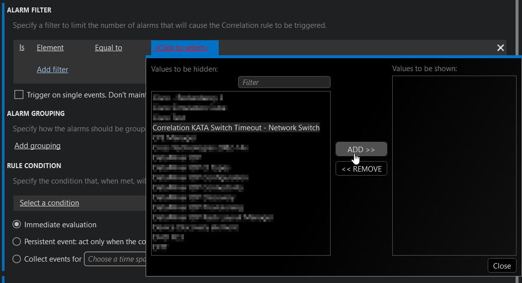

  4. Under ALARM FILTER, configure a filter so that the correlation rule will only be applied for alarms from the element Correlation KATA Switch Timeout - Network Switch:
    1. Click Select a filter.
    2. In the dropdown list, select Element.
    3. Click the field to the right of Equal to.
      This will open a pane where you can select an element.
    4. In the pane, select Correlation KATA Switch Timeout - Network Switch, click ADD >>, and then click Close.
      Adding an alarm filter

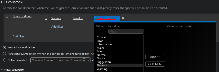

  5. Under RULE CONDITION, add a rule condition that will trigger the rule when the severity is equal to Timeout.
    1. Click Select a filter, and select Filter condition.
    2. To the right, click Select a filter, and then select Severity on the dropdown list.
    3. Click the field to the right of Equal to, select Timeout, click ADD >>, and then click Close.
      Adding a rule condition

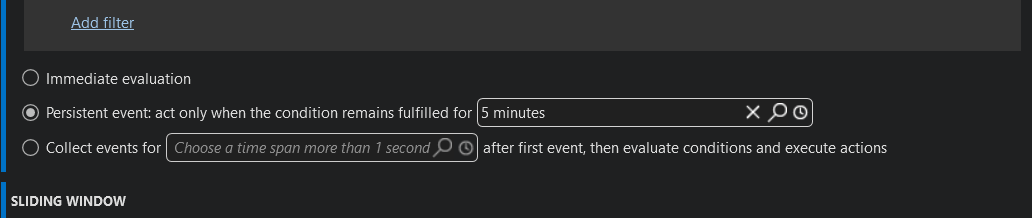

  6. Below the rule condition configuration, select the Persistent event trigger mechanism and fill in 5 minutes.
    With this configuration, the correlation rule will wait until the rule conditions have been met for 5 minutes before acting and executing its actions.
    Configuring persistent event time

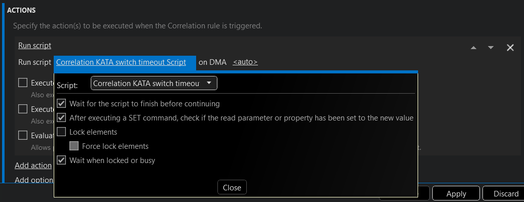

  7. Under ACTIONS, configure an action to run a script that will generate an information event:
    1. Click Add action and select Run script.
    2. Next to Run script, click <empty> and select the script Correlation KATA switch timeout Script.
      This automation script will generate an information event when executed.
      Adding the run script action
