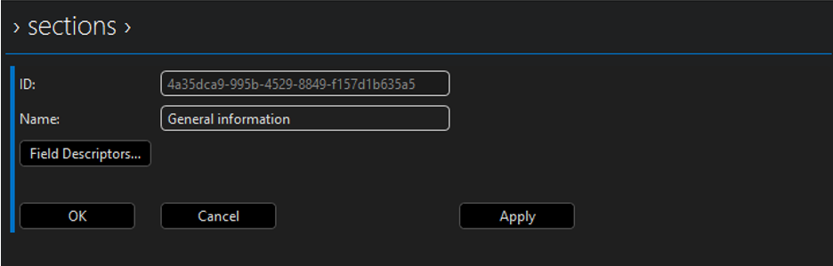

  3. Click Section Definitions, and then click New.
  4. In the Name box, fill in the name of the section.
    DOM Editor: new section
  5. Click Apply.

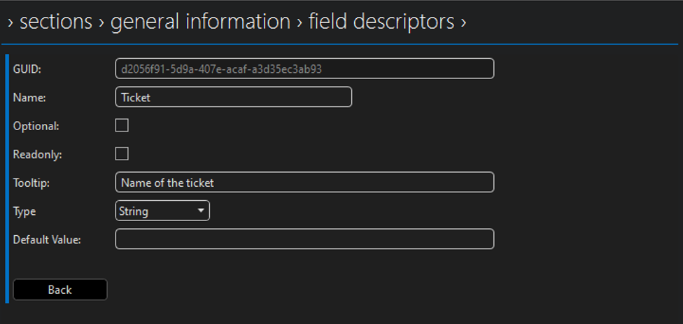

  6. Add fields to the section:
    1. Click Field Descriptors, and click the + button.
    2. Fill in the necessary information for the field and click Back.
      DOM Editor: configuring a field
    3. Click Field Descriptors again and repeat the steps above until you have added all the necessary fields.
    For more information on the field descriptor configuration, see FieldDescriptor.
