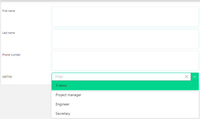

After you have soft-deleted the enum entry, you should no longer see it listed in the JobTitle dropdown list in your low-code app.
Step2

After the enum value has been removed, it should no longer be visible in your low-code app.
Step3

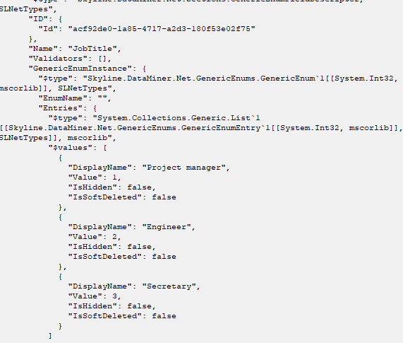

            domHelper.SectionDefinitions.Update(sectionDefinition);
Inspect the DOM definition with the SLNetClientTest tool. The enum entry is now completely removed.
Step4
