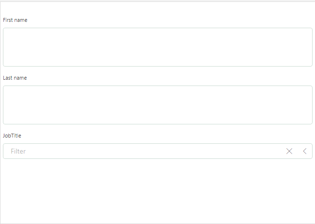

After you have implemented this, the field descriptor is soft-deleted, and you should no longer see it in your low-code app when you create a new instance.
Low-code app example

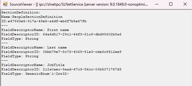

Step 5 - Optional: Inspect the SectionDefinition with SLNetClientTest tool
If you want to be entirely sure the phone number is completely removed, you can inspect the SectionDefinition with the SLNetClientTest tool.
Warning
Always be extremely careful when using SLNetClientTest tool, as it can have far-reaching consequences on the functionality of your DataMiner System.
  1. Open the SLNetClientTest tool.
  2. Select Advanced > Apps > DataMiner Object Model.
    The different module settings will be shown.
  3. Select the one you want to inspect (in this case "people_app") and click Open.
  4. At the top, select the SectionDefinitions tab and open the definition you want to inspect.
    In this case, you will see that the phone number has been completely removed from the SectionDefinition:
