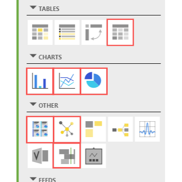

This tutorial demonstrates how to add a custom message when a query returns no results for any of the following components of a dashboard:
- Table
- Grid
- Pie & donut chart
- Column & bar chart
- Line & area chart
- Timeline
- Node edge graph.

- Drag and drop any of the above-mentioned components to the dashboard, for example a table.
DataMiner 10.3.11 with soft-launch options ReportsAndDashboardsScheduler and ReportsAndDashboardsDynamicVisuals enabled.
- Add a query to the component.

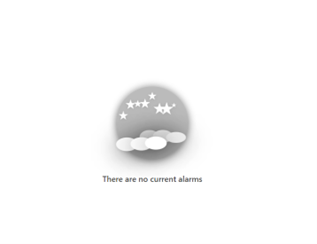

Under Advanced, set the Empty result message to the message you want the component to display when no data is returned for the query.
The custom message will now be properly configured.
The example above will result in the following message:
