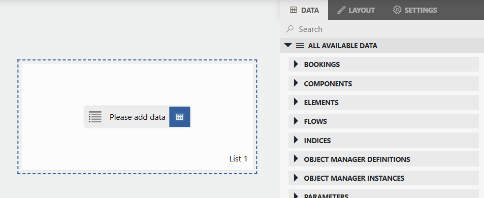

The Elements data category allows you to use data from elements in your DataMiner System as input for components in your dashboards or low-code apps.
When you expand the Elements section in the Data pane, a list of available elements is displayed.
To quickly find a specific element, use the filter box at the top of the data section. From DataMiner 10.2.5/10.3.0 onwards, you can click the filter icon next to the filter box to get additional filtering options:
  • Specify a view in the View bow to only load elements in that view (and its subviews).
  • Specify a protocol in the Protocol box to only load elements using that protocol.
  • Select the EPM managers checkbox to only load EPM Manager elements.
  • Select the Spectrum analyzers checkbox to only load Spectrum elements.
To use all elements in your DataMiner System as data input, select the Elements header and drag it onto a compatible visualization.
