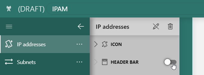

Make sure you are editing the app.
In the gray side panel on the left, next to Header bar, toggle the switch to the right.
This will add a header bar to your page.

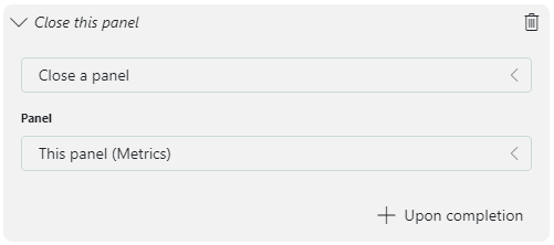

Do not specify a name for the button.
Configure the Close a panel action, so that the panel closes when a user clicks the header bar button.
Publish the app and check if clicking the new button in the panel header closes the panel.
