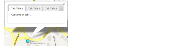

PopupSkeleton and PopupDetails
In the <PopupSkeleton> and <PopupDetails> tags, you can specify the contents of the balloon that will appear when you click a marker.
PopupSkeleton
In the <PopupSkeleton> tag, specify all fixed content, including the necessary placeholders for variable data. Use HTML syntax inside a CDATA tag and put the placeholders between square brackets.
  • Marker balloons can contain tab controls. These tab controls, which are based on a CSS class called "tabs", have to be designed as shown in Showing values returned by an SQL query: an enumeration of the tab titles, followed by the contents of each tab.
  • The placeholders [latitude], [longitude], and [alarmstate] can be used directly in the PopupSkeleton definition without the need to define them in a PopupDetails element. They will display the coordinates and alarm state of the actual marker, respectively.
  • You can specify a list of EPM tables in the PopupSkeleton tag, which will be displayed in a marker pop-up balloon. For an example, see Displaying EPM tables in a marker pop-up balloon.

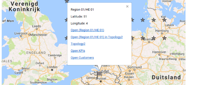

Examples of PopupSkeleton and PopupDetails configuration
Showing cell values from a dynamic table row
An example where placeholders are replaced by cell values from the currently selected dynamic table row:
<PopupSkeleton>
  <![CDATA[
    <p>Latitude: [latitude]</p>
    <p>Longitude: [longitude]</p>
</PopupSkeleton>
<PopupDetails>
  <Detail name="latitude" type="parameter_samerow" pid="114" />
  <Detail name="longitude" type="parameter_samerow" pid="116" />
</PopupDetails>

Adding tab pages to a marker balloon
An example of a marker balloon with three tabs:
<PopupSkeleton>
  <![CDATA[
    <div class="tabs" style="font-size:12px;height:100px;width:300px;">
      <ul>
        <li>
          <a href="#tabs-1">Tab Title 1</a>
        </li>
        <li>
          <a href="#tabs-2">Tab Title 2</a>
        </li>
        <li>
          <a href="#tabs-3">Tab Title 3</a>
        </li>
      </ul>
      <div id="tabs-1">Contents of tab 1.</div>
      <div id="tabs-2">Contents of tab 2.</div>
      <div id="tabs-3">Contents of tab 3.</div>
    </div>
</PopupSkeleton>
On the map, the above-mentioned code will be rendered in the following way.

It is possible to configure the <PopupSkeleton> tag so that a user can navigate from the pop-up balloon to the EPM interface or display particular EPM information from the pop-up balloon.
To do so, you can use the following JavaScript methods:
  • NavigateCPEChain(int dataminerID, int elementID, string chain, int columnOrTablePid, string primaryKey)
    Selects an item in the EPM interface on the given element and chain. To only open the chain, set the last two arguments to -1 and ''.
  • OpenCPEKPIPopup(int columnOrTablePid, string value)
    Opens a KPI pop-up window on the current chain of the given item.
  • OpenCPELinksPopup(int columnOrTablePid, string value, string linksName)
    Opens the links pop-up window with the name passed in linksName on the current chain of the given item.
  • OpenCPEKPIPopupFromChain(string chain, int columnOrTablePid, string value)
    Opens the KPI pop-up window on the given chain of the given item.
  • OpenCPELinksPopupFromChain(string chain, int columnOrTablePid, string columnPK, string linksName)
    Opens the links pop-up window with the name passed in linksName on the given chain of the given item.
Example:
<PopupSkeleton>
  <![CDATA[
    <p>[dispkey]</p>
    <p><a href="javascript:window.external.NavigateCPE([dmaid], [eid], [pid], [pid], '[primarykey]');">Open ([dispkey])</a></p>
    <p><a href="javascript:window.external.NavigateCPEChain([dmaid], [eid], 'topology2', [pid],'[primarykey]');">Open ([dispkey]) in Topology2</a></p>
    <p><a href="javascript:window.external.NavigateCPEChain([dmaid], [eid], 'topology2', 0,'');">Topology2</a></p>
    <p><a href="javascript:window.external.NavigateCPEChain(57, 7, 'topology2', 0,'');">Topology2 on other element</a></p>
    <p><a href="javascript:window.external.OpenCPEKPIPopup([pid],'[primarykey]');">Open KPIs</a></p>
    <p><a href="javascript:window.external.OpenCPELinksPopup([pid],'[primarykey]', 'Customers');">Open Customers</a></p>
</PopupSkeleton>
