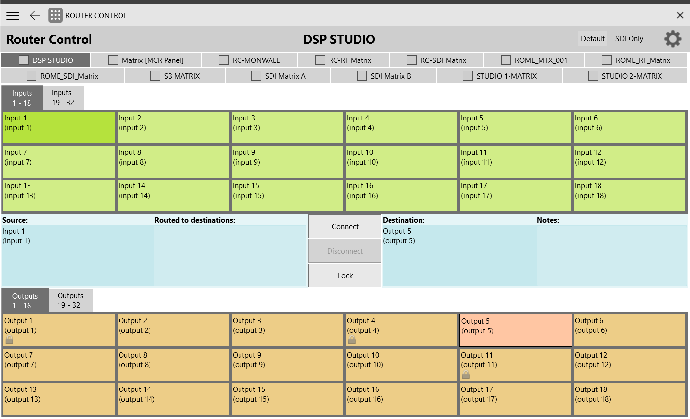

DataMiner Router Control is a DataMiner module that allows you to intuitively configure the matrices in your DataMiner System in a single, customizable user interface.
When you open the module for the first time, you will find a default user interface (called a configuration) that contains a tab page for every standard matrix found in your DMS. If no standard matrices have been defined yet, a message will be displayed instead.
Router Control app
Router Control module in DataMiner 10.6.2
Next to the default configuration, you can create additional configurations. All configurations (including the default) can be customized.
