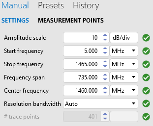

In the Settings pane, in the tab Manual > Settings, you can modify the settings like any other parameter in Cube. Just enter or select the new value, and click the green tick mark. If you want to modify several settings at the same time, you can also specify the new values and then click Apply all below the list of settings.
Manual settingsSpectrum analyzer settings in DataMiner 10.4.1
