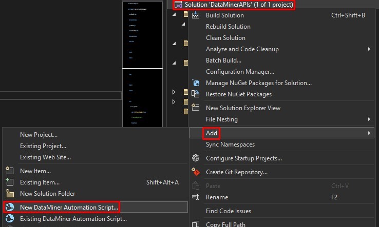

  1. In Visual Studio, right-click the solution at the top of the Solution Explorer, and select Add > New DataMiner Automation Script.
    Visual Studio add new automation script solution

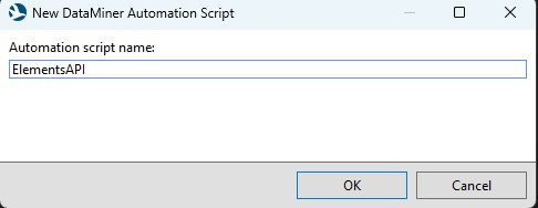

  2. In the dialog, enter the name "ElementsAPI".
    Create new automation script solution

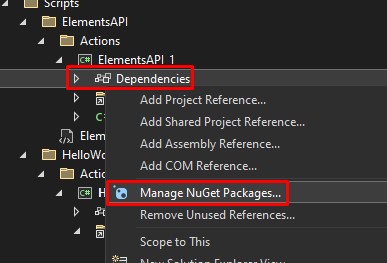

To use JSON, you will need to include the Newtonsoft.Json NuGet package.
  1. In Visual Studio, right-click the project ElementsAPI_1 and click Manage NuGet packages.
    Visual Studio project dependencies
  2. In the window that opens, click Browse at the top.
    Visual Studio NuGet browse
  3. Now search for "Newtonsoft.Json", and click the first package.
  4. On the right, click Install.
    Install Newtonsoft.Json

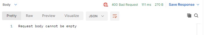

            if (string.IsNullOrWhiteSpace(requestData.RawBody))
                return new ApiTriggerOutput()
                    ResponseBody = "Request body cannot be empty",
                    ResponseCode = (int)StatusCode.BadRequest,

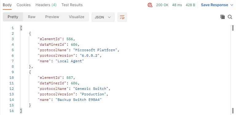

                ResponseBody = JsonConvert.SerializeObject(elements, _serializerSettings),
                ResponseCode = (int)StatusCode.Ok,

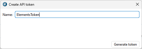

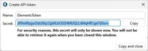

  3. Under Tokens, click Create
  4. For the Name, enter "ElementsToken", and click Generate token.
    Create API token
  5. Copy the generated secret to a safe location (e.g., a password manager).
    Create API secret
    After closing this window, you will no longer be able to retrieve the secret. Make sure that the secret is saved somewhere safe. If it is lost, a new token will have to be created.

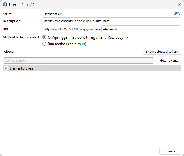

  1. Open the Automation module in DataMiner Cube.
  2. Open the ElementsAPI automation script.
  3. At the bottom of the screen, click the Configure API button.
  4. Optionally enter a description for the API.
  5. For the URL, enter "elements".
  6. In the bottom Tokens pane, select the ElementsToken, which was created in the previous step.
  7. Finally, click the Create button.
    Create API window

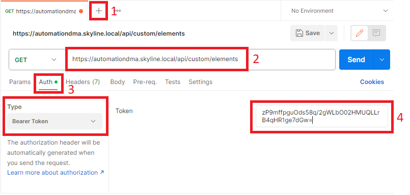

Step 4: Trigger the API using Postman
The API is now ready to be tested using an API testing app like Postman. If you have never used Postman before, check step 5 of the hello world tutorial for more detailed information.
  1. Open Postman and click the + icon to create a new request.
  2. In the URL field, enter https://HOSTNAME/api/custom/elements, replacing "HOSTNAME" with the hostname of the DataMiner Agent.
  3. Go to the Authorization tab and select Bearer Token as Type.
  4. In the Token field, enter the API token secret that you copied in step 2.
    Postman UI new request
  5. Click the blue Send button.
    You should get a Bad Request status code with the validation error that was added in the script. This happens because no body was provided in the request. This proves that the validation logic works as expected.
    Postman UI response error
  6. Open the Body tab of the request.
  7. Change the body type from none to raw in the dropdown.
  8. Change the content type from text to JSON.
    Postman UI add request body
  9. Enter the JSON input below the selectors.
        "alarmLevel": "Minor",
        "limit": 10
  10. Click the blue Send button again.
    The API will be triggered, and all elements that have minor alarms should be returned.
    Postman UI response
