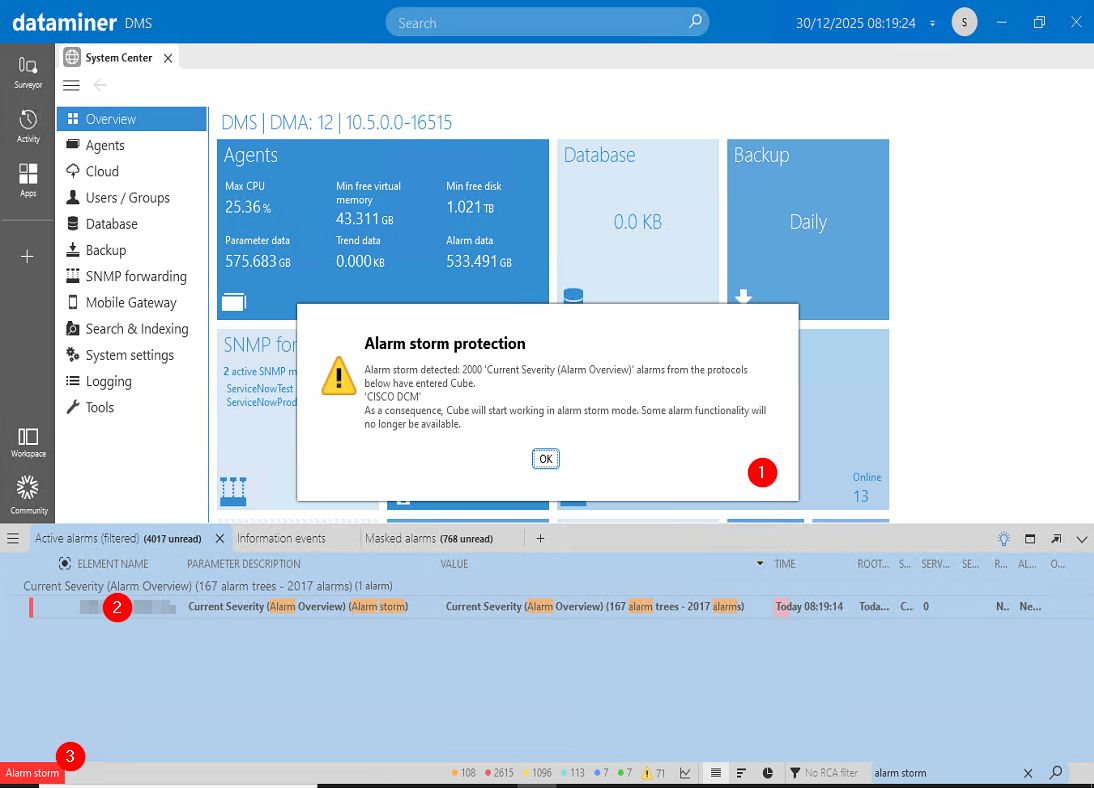

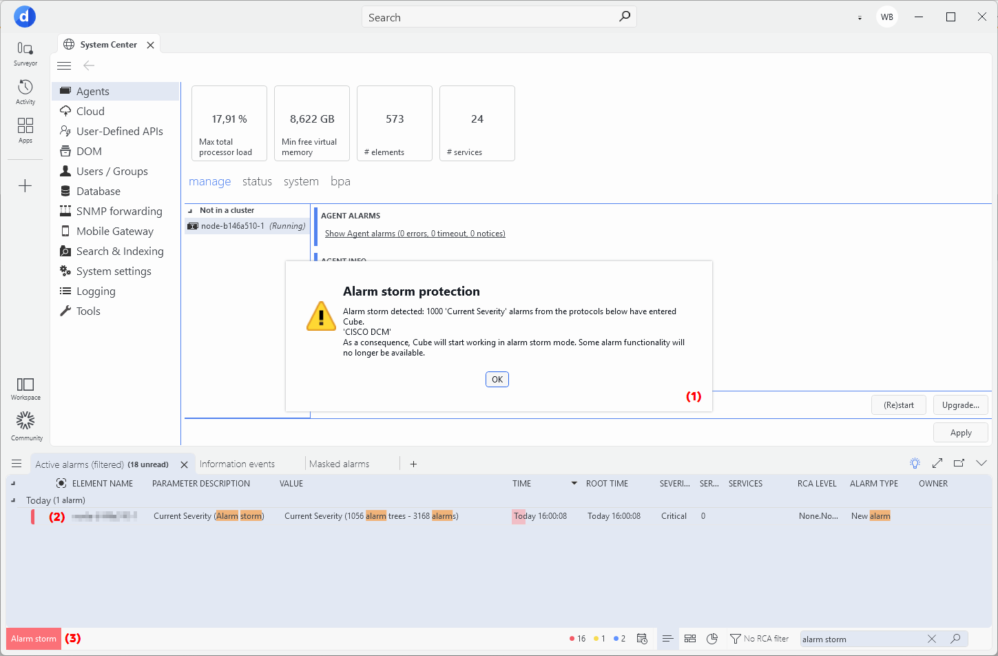

When the Cube alarm storm protection is triggered, the following happens:
Alarm Storm Visuals
Alarm storm in DataMiner Cube 10.6.5
  • A pop-up message appears, mentioning that alarm storm mode is activated with some additional information on the alarms coming in ("1" in the image above).
  • Depending on the enabled type(s) of alarm storm protection, the following happens:
    • Alarms with the same parameter description that exceed the alarm storm start threshold are grouped into one alarm, similar to a correlated alarm ("2" in the image above). This alarm will mention "Alarm storm" in the Parameter Description column and the number of generated alarms in the Value column.
    • If more alarm updates enter than the alarm storm start threshold, alarms are delayed for the configured time period. Any alarms that are cleared before this delay has passed will no longer be displayed.
  • In the alarm bar, a red button labeled "Alarm storm" appears ("3" in the image above).
    • If alarm storm protection by grouping is activated, you can hover over this notification in order to see an overview of the parameters in alarm storm mode as well as the number of alarms per parameter description.
    • If alarm storm protection by delaying is activated, you can click this notification to open a new card with a list of the delayed alarms. This card is not updated automatically, but a refresh button is available to update the displayed information.

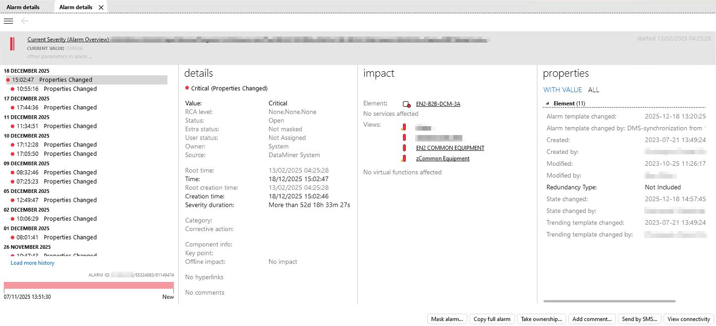

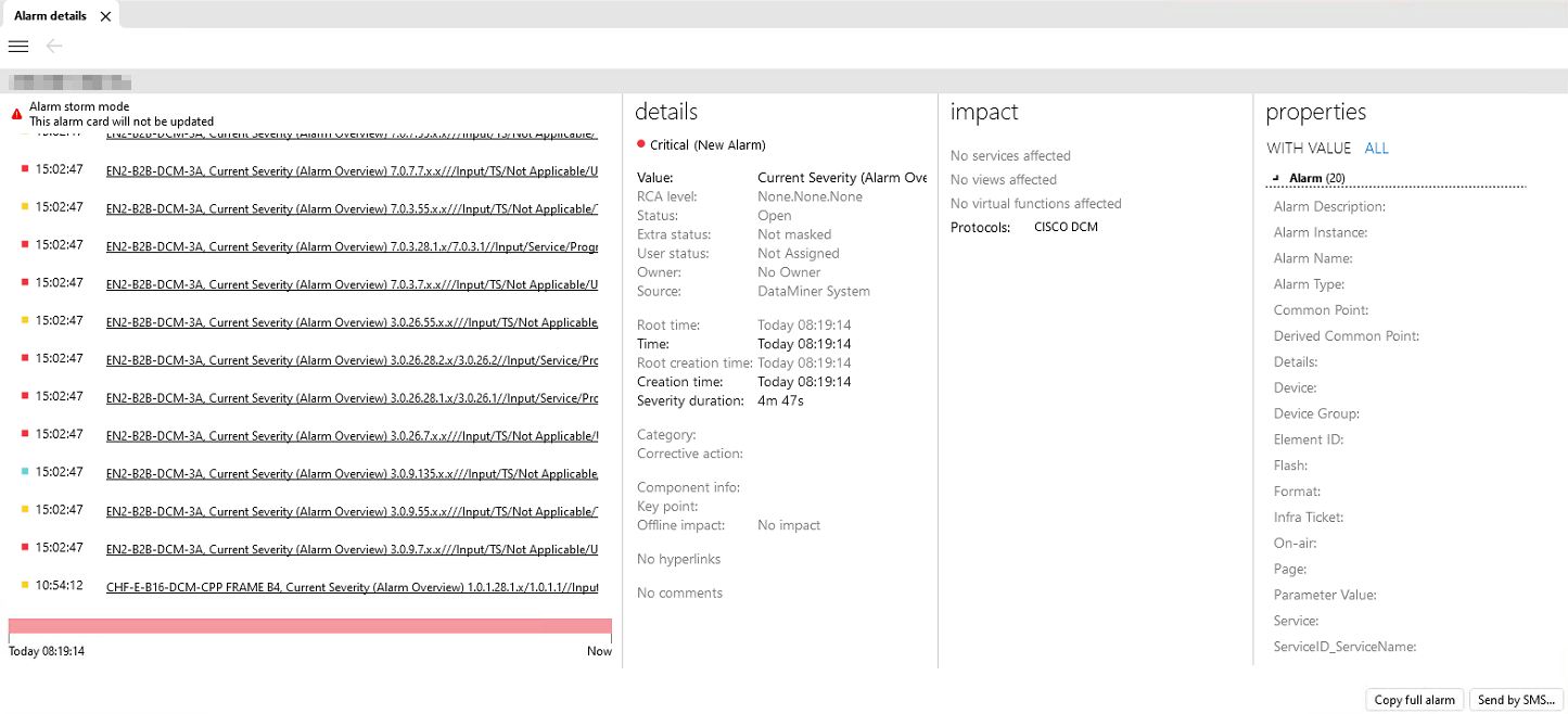

  1. Right-click the alarm entry in the Alarm Console to open the alarm card. For example:
    Alarm storm details
    Alarm card for alarm storm in DataMiner Cube 10.6.1
  2. Based on the details on the alarm card, try to answer the following questions to gain insight in the situation:
    • Which alarm events recur most often?
    • Over which period of time have the alarms accumulated?
      • Short time period: The cause is most likely a specific action. For example, if a new Agent with an incorrect server configuration is added, this may generate a large number of sync notices, causing an alarm storm.
      • Extended time period: The cause is most likely a configuration problem. For example, it can occur that alarms never get cleared, making them stack up and cause an alarm storm. This could be because of badly written table logic in a connector or because the AutoClear option is set to false in MaintenanceSettings.xml.
    In the example screenshot shown above, you can see that the issue is related to Cisco DCM elements, specifically the colums Current Severity in the Alarm Overview table.
  3. Check the alarms listed on the alarm card of the alarm storm for additional details.
    For example, in the example illustrated below, there are recurring Properties Changed alarm updates, suggesting that a property keeps getting updated, causing new alarm events. If these updates are not needed for this property, the fix for this example will be to disable the option Update alarms on value changed for the alarm property. (See Changing custom alarm properties).
