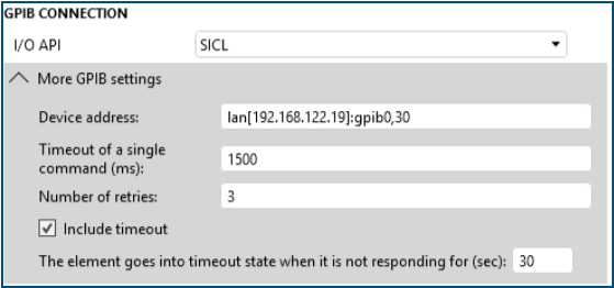

  • Device address: gpib0,10
    "gpib0" is the Remote SICL Interface Name, and "10" is the GPIB bus address as set on the device (range: 0-30). Default device address: “gpib0”.
    If multiple GPIB interfaces or multiple network interfaces are being used, the device address has to be specified as follows: "lan[machineName]:gpib0,1".
    "lan" is the "SICL Interface name" in the IO configuration, and "machineName" is the IP address of the network GPIB interface.
    GPIB Connection
    GPIB connection settings in DataMiner 10.6.5
