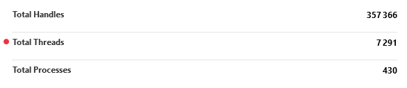

Read parameters versus write parameters
Read parameters
Read parameters display a read-only value that has been retrieved from a device.
Read parameters
Read parameter in DataMiner 10.4.5
The way this value is displayed depends on whether it is a discrete or an analog value.
  • Discrete values can only be displayed as text.
  • Analog values can be displayed as text, LED bars, oscilloscopes, or colored tubes.
  • Sometimes parameter values are only retrieved when a particular button is clicked (e.g., Refresh, Load, etc.). This is common practice for less important parameters.
  • Unavailable read parameters are always shown in gray.
