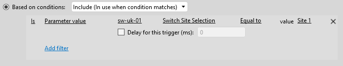

  3. Select the ird-uk-lon-01 element and configure the following details in the pane on the right:
    1. In the Alias field, specify Site 1.
    2. Clear the All parameters checkbox.
    3. Select the Audio Output Level parameter.
    4. Under THIS ELEMENT IS INCLUDED IN THE SERVICE, select Based on conditions and Include (In use when condition matches).
    5. Click Add condition and configure the following condition:
    Is Parameter value sw-uk-01 Switch Site Selection Equal to value Site 1
    The configuration for this element should now look like this:

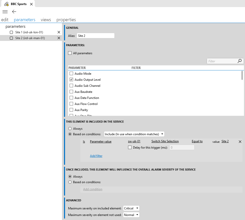

  4. Select the ird-uk-man-01 element and configure the following details in the pane on the right:
    1. In the Alias field, specify Site 2.
      Is Parameter value sw-uk-01 Switch Site Selection Equal to value Site 2
    Element configuration for ird-uk-man-01
  5. Click Apply to save the changes.
Now your service will only include the element that is active based on the Switch Site Selection parameter from the sw-uk-01 element. Switching this parameter from Site 1 to Site 2 and vice versa will change the included element. This makes sure you will get the live status of your service regardless of the source of your signal.

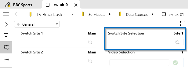

Switch position

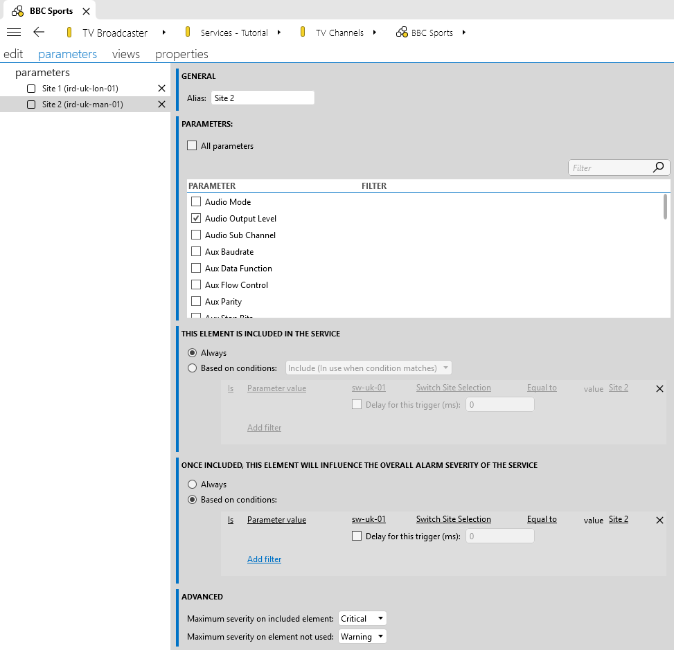

    1. Under THIS ELEMENT IS INCLUDED IN THE SERVICE, select Always.
    2. Under ONCE INCLUDED, THIS ELEMENT WILL INFLUENCE THE OVERALL ALARM SEVERITY OF THE SERVICE, select Based on conditions.
    3. Add the condition Is Parameter value sw-uk-01 Switch Site Selection Equal to value Site 2.
    4. Under ADVANCED, configure the option Maximum severity on element not used and set it to Warning.
  6. Open the sw-uk-01 element and change the Switch Site Selection parameter to Site 2.
Now your service will include both elements, but the service will indicate the one that is in use. The source that is not active will at most cause a warning alarm on the service.
In Cube, you will now see a warning alarm on the service coming from the signal from Site 1, while the signal from Site 2 is working fine. This way, you will be able to spot problems with the other signal early, before you need to use it.
