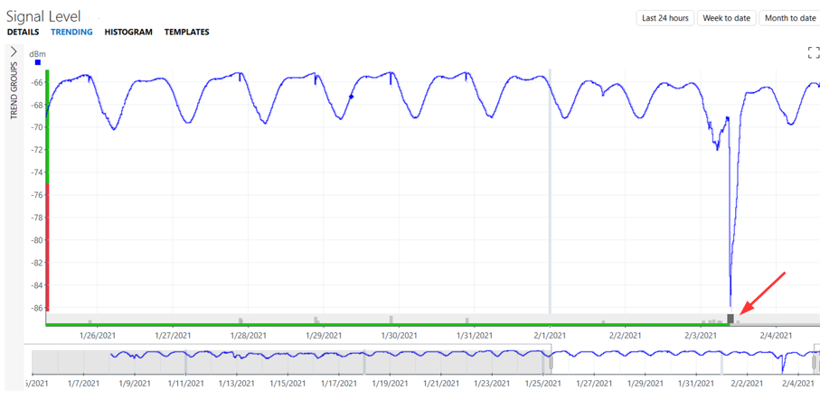

Change points in trend graphs
On a trend graph, a change point is indicated by a bar below the graph. The length of the bar indicates the approximate time frame in which the change started, the height of the bar indicates the importance of the change, and the color of the bar indicates the severity. From DataMiner 10.4.1/10.5.0 onwards, the color is typically light gray, unless the change point was severe enough to trigger an event. Then, in case alarm monitoring is activated for change points, the color reflects the severity of the triggered alarm. In case alarm monitoring is not activated, the color is dark gray.
When you hover the mouse pointer over a change point bar, a semi-transparent ribbon will be displayed over the entire height of the trend graph, showing more information about the change point.
Labels of change points of type “trend change” will indicate the level of increase or decrease in seconds, minutes, hours or days depending on the value. If, for example, the value increases by 0.01 per second (i.e. 0.6 per minute, 36 per hour or 864 per day), the label will show an increase of 36 per hour as it is the smallest amount greater than 1.
