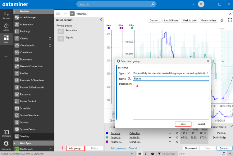

Adding a trend group
To add a trend group:
  1. Click the Add group button.
  2. Specify the type of trend group:
    • Private: Only you will be able to use or update the trend group.
    • Protected: Other users in the DMS will be able to use the trend group, but only you will be able to update it.
    • Public: All users in the DMS will be able to use and update the trend group.
  3. Specify a name for the trend group.
  4. Optionally, add a short description in the Description field.
    This description will be shown under the name of the group in the trend group pane.
Saving a trend group in DataMiner 10.6.5
Alternatively, you can also add parameters in the parameter pane and click the Save as button to save these as a trend group.
