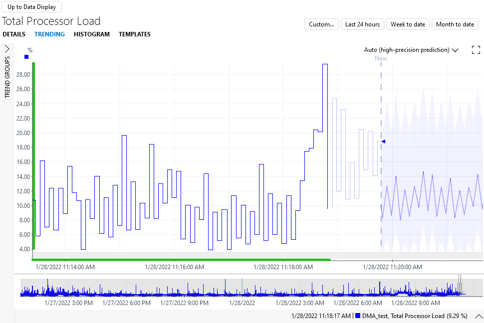

Depending on the type of data that is displayed, the trend line looks different. For example, take a look at this trend graph in DataMiner 10.6.5:
Trend graph in DataMiner Cube
  • The dark full line represents trend information retrieved from the database.
  • The light full line represents either the most recent real-time parameter change events, or "history datasets", i.e., parameter change events that are being drawn in the past.
  • The dotted line past "Now" represents trend prediction data.
