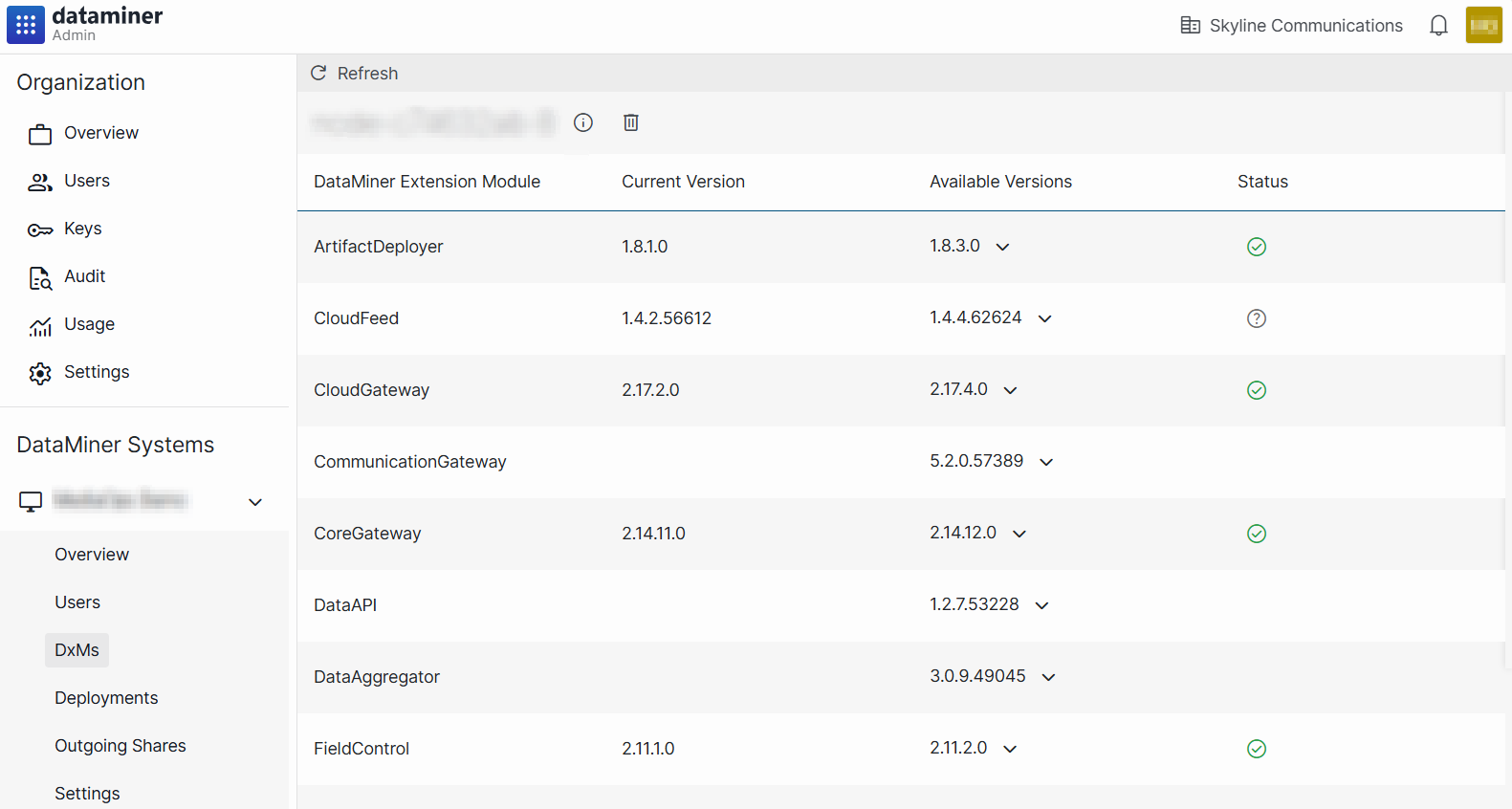

  3. In the Admin app, go to the DxMs page for the DataMiner System and verify the DxM status of the DataMiner Agent node.
    The SupportAssistant and CoreGateway DxMs are the most important for CDMR reporting, so check whether a green check mark is shown for these. If there is an issue with the DxMs, refer to dataminer.services troubleshooting.
    DxMs overview
  4. Check whether your system meets the minimum requirements for remote log collection.
  5. If any of the DxMs listed in the Admin app need to be upgraded to meet the requirements, upgrade the DxMs.

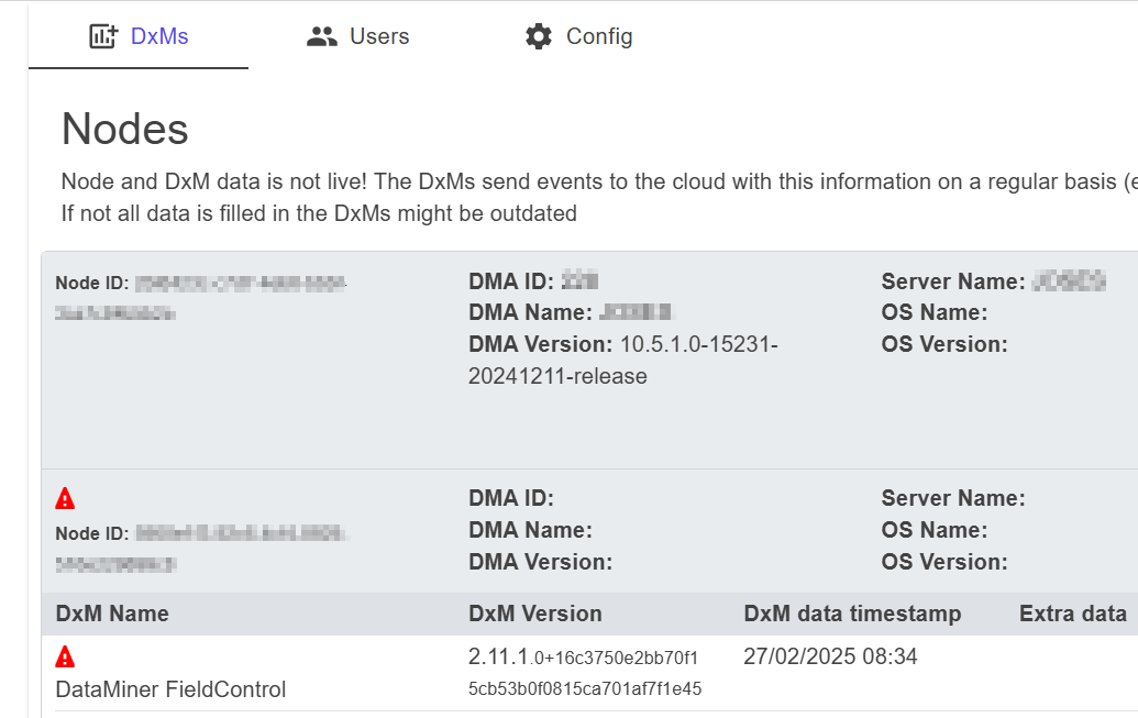

    4. In the DxMs tab of the Skyline Admin tool, check the DxM status, especially for DataMiner SupportAssistant and DataMiner CoreGateway.
      Skyline Admin: DxM info

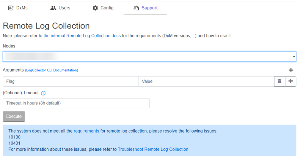

    5. In the Support tab, select the DataMiner Agent node that is no longer reporting and check if any errors are shown.
      Skyline Admin: Support info
