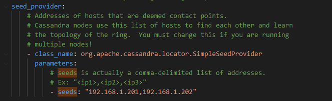

If the dead Cassandra node was a seed node, change the cluster's seed node configuration on each node.
To do so, in the cassandra.yaml file of each node, replace the IP address of the dead node from the seeds list with the IP address of the new node.
Example of seeds list in Cassandra.yaml file

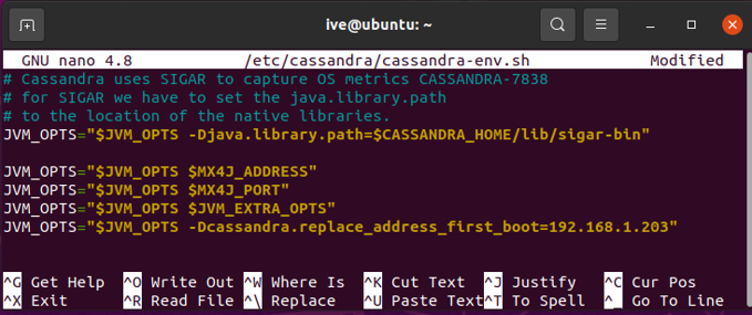

Start the new node with the replace_address option
On the new node, edit the Cassandra-env.sh file and add the following:
JVM_OPTS="$JVM_OPTS -Dcassandra.replace_address_first_boot={ip of dead node}"
For example:
Example of how to start the new node
When this is done, start the Cassandra service, using the following command:
sudo service cassandra start

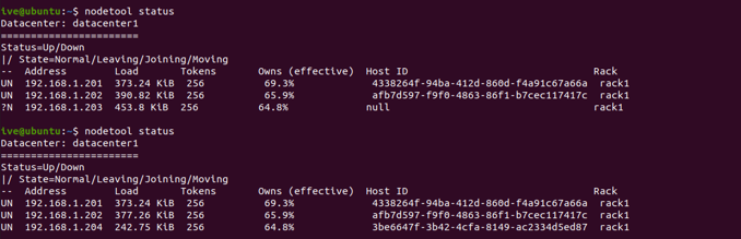

Check whether the new node remains in the DN state until bootstrapping is completed. You can check progress using the following command:
nodetool netstats
Confirm that the new node has replaced the dead node using the following command:
nodetool status
Example of how to confirm that the new node has replaced the dead node

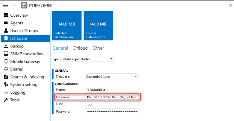

Update DataMiner
In DataMiner Cube, go to System Center > Database. In the DB server box, replace the IP address of the dead node with the IP address of the new node.
For example, in DataMiner 10.2.0:
Example of System Center configuration
